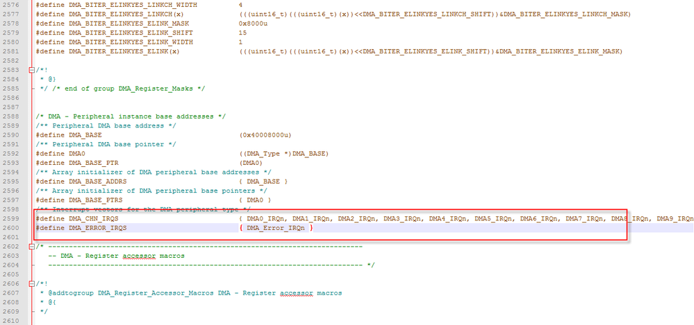

So I was having a problem with my KSDK 1.2 based projects that used DMA, using KDS 3.0 where no matter what I was doing, they were dropping into the default IRQ.
When I started to dig I found that the DMA IRQ's were undeclared, and greyed out as not defined inside of the edma_irq file, because of a value called FSL_FEATURE_SOC_DMA_COUNT contained in the MK2251212_features.h file.
FSL_FEATURE_SOC_DMA_COUNT (0) ----> When I change this value to 16 (can't remember off hand but I think that's the number of DMA channels?), I get my DMA IRQ handler, and everything runs as it is supposed to. Not sure if this is the correct way to solve this, but would appreciate some input.

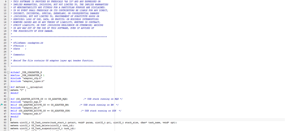

What is the major difference between the SDK and BM adapter for the USB stack? Is there a specific reason that an example BM project has SDK selected in the adapter_config.h - is this correct? Because some of the example I've looked at are setup like this.
Thank you.

For question 1, I don't think changing FSL_FEATURE_SOC_DMA_COUNT (0) to 16 is a correct solution, actually there is no DMA module in K22F51212 , just eDMA available, so you may find #define FSL_FEATURE_EDMA_MODULE_CHANNEL (16) in the line 364 of MK22F51212_features.h, and DMA irq numbers in MK22F51212.h like below:

For question 3, I think the following figure shows the difference, and since the USB stack uses low layer drivers from KSDK, so the examples selected SDK as the adapter in adapter_cfg.h.

On #1 - If that's not the correct solution, then you guys should change the define in fsl_edma_irq.c to reflect the correct constant.
You have :
#include "fsl_edma_driver.h"
#if FSL_FEATURE_SOC_DMA_COUNT
Right at the top of the file. I would say you may want to have it be FSL_FEATURE_EDMA_MODULE_CHANNEL, if that's what it's actually supposed to depend on.

Just some supplement for question 3:
For BM , SDK and RTOS like MQX , USB stack have a different OS APIs for each of them, so with different adapters we can make one code be used for all of them.
Kan
