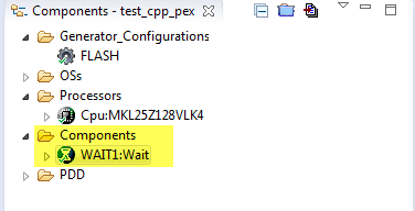

I is listed here:
You can double click on it to add it to your current project, or drag and drop it into the components view (onto the 'Components' folder):

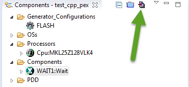

Then Generate Code with this button:

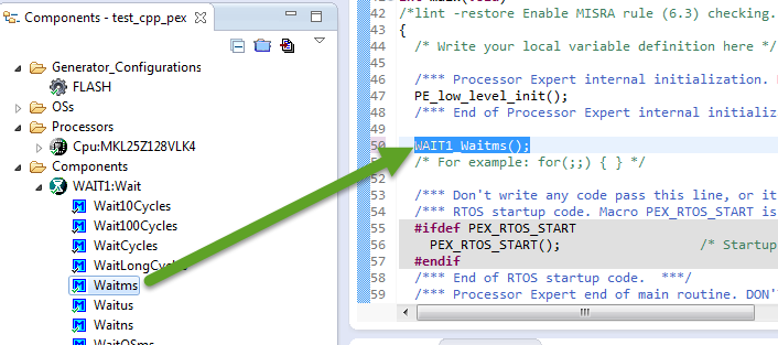

You can drag&drop method names to your source:
And then use parameters as needed/specified:
  WAIT1_Waitms(500); /* wait 500 ms */
If you are using it in your own source file, do not forget to include the header file:
#include "WAIT1.h"
