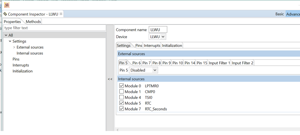

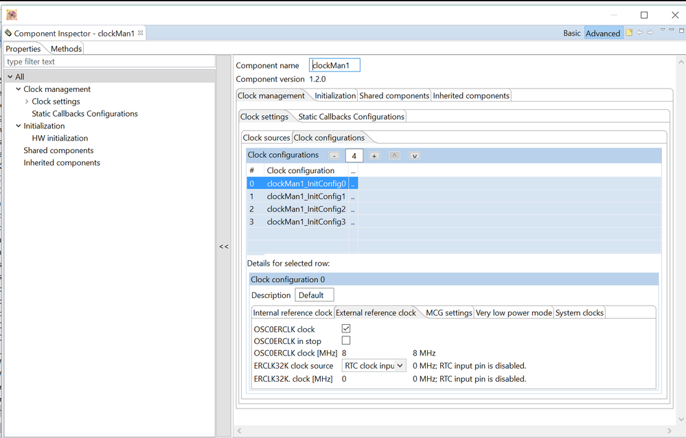

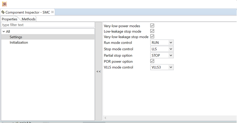

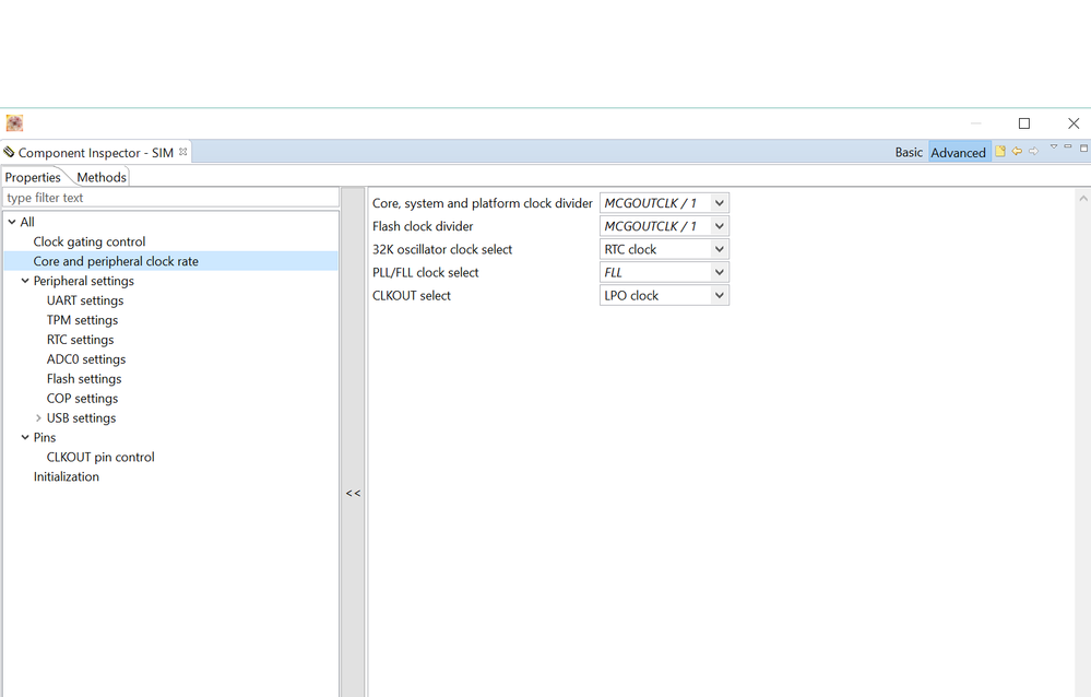

I'm doing an IoT project with the Kl25z freedom board, and I have a problem switching between power modes. I want to put the kl25z into LLS mode and wake it up with a pulse counting event from the LPTMR or a RTC clock alarm. I manage to put the kl25z to LLS but then it never wakes up. I tested the RTC and LPTMR ISRs and they work fine while the MCU is in Run mode. I'm using KDS and KDSK v1.2. I'm sourcing the RTC_CLKIN pin with a 32.768kHz lab function generator oscillator. Here goes the pictures of my PE configuration:
clock config:130784_130784.pnglls1.png
SIM config:130785_130785.pnglls2.png

I made a quick review on your files and could notice that you are masking the LLWU interrupt, but if you check KL25's reference manual, in section 15.1.2.1 LLS mode, there is a note that specifies about LLWU interrupt must not be masked by the interrupt controller to avoid a scenario where the system does not fully exit stop mode on an LLS recovery, so i think that is your problem.

Thank you Issac! I tried your example and worked, I think the problem was the masked LLWU interruptions.
