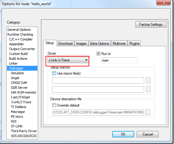

Hello Aaron,
In the debugger configure view , please select the "J-LINK/J-Trace" . Even we use the OpneSDA firmware , it is open Jlink.
I just test it , it can work well on my side , if it still have error , please tell me .

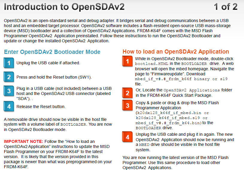

Hello Aaron,
Do you want to use the mbed firmware to debug , ok , it also be ok.
I forget the default firmware , while it doesn't matter, please first copy and past the firmware ""k20dx128_k64f_if_mbed.bin"
to the bootloader , about the detail steps you can refer to the "FRDM-K64F Freedom Development Platform -Quick Start Guide":
I have test the two method to debug on IAR, both are ok , if it still can not work , please show me your steps .
Hope it helps
