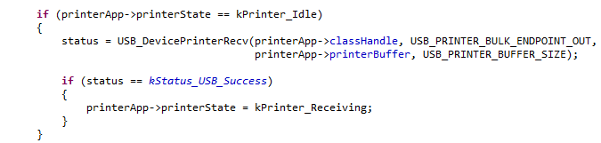

In "device_printer.c" in the "USB_DevicePrinterAppTask" function, it schedules a USB printer receive and then sets the state flag. The way it does this is not atomic and causes issues when sending print jobs.

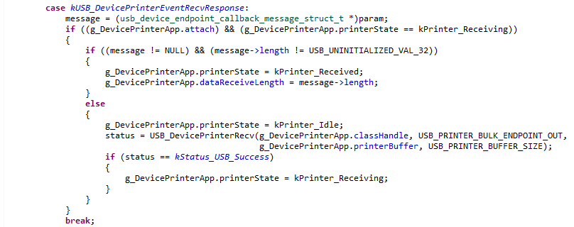

Once the USB receive has been scheduled, USB interrupts are free to run. If it receives data before it sets the "printerState", the "USB_DevicePrinterAppCallback" does not handle this because the printerState is not "kPrinter_Receiving" yet.
If the printerState is not "kPrinter_Receiving", the printerState never changes to "kPrinter_Received" and therefore the data is ignored and missed and now the state machine is locked up and stuck in the "kPrinter_Receiving" state. It's locked up because the receive event already happened before the state changed to "kPrinter_Receiving".

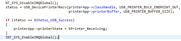

The solution is to make the USB receive schedule fully atomic like so:
This way a USB receive can only happen AFTER the printerState is set.
