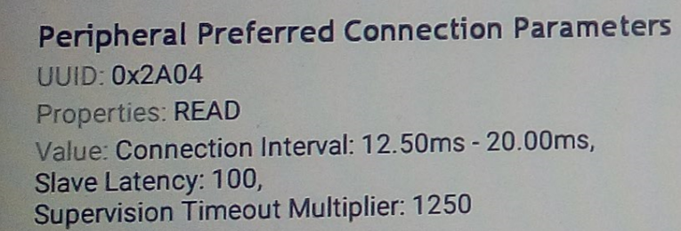

24. ble_general.h defines should be check against standard limits and
should be correlated to values used in gatt_db.h on Peripheral Preferred Connection Parameters Characteristic
/*! Boundary values for the Connection Parameters (Standard GAP) */
#define gcConnectionIntervalMin_c                   (0x0006)
#define gcConnectionIntervalMax_c                   (0x0C80)
#define gcConnectionSlaveLatencyMax_c               (0x01F3)
#define gcConnectionSupervisionTimeoutMin_c         (0x000A)
#define gcConnectionSupervisionTimeoutMax_c         (0x0C80)
/*! Default values for the Connection Parameters (Preferred) */
/*! connIntervalmin = Conn_Interval_Min * 1.25 ms */
/*! Value of 0xFFFF indicates no specific minimum */
#ifndef gcConnectionIntervalMinDefault_c
#define gcConnectionIntervalMinDefault_c            (40)
#endif
/*! connIntervalmax = Conn_Interval_Max * 1.25 ms */
/*! Value of 0xFFFF indicates no specific maximum */
#ifndef gcConnectionIntervalMaxDefault_c
#define gcConnectionIntervalMaxDefault_c            (160)
#endif
#ifndef gcConnectionSlaveLatencyDefault_c
#define gcConnectionSlaveLatencyDefault_c           (0)
#endif
ble_sig_defines.h
  /*! GAP Peripheral Preferred Connection Parameters Characteristic UUID */
  /* https://www.bluetooth.com/specifications/gatt/viewer?attributeXmlFile=org.bluetooth.characteristic.g... */
  #define gBleSig_GapPpcp_d                       0x2A04
  /*! GAP Peripheral Preferred Connection Parameters Characteristic Value Fields */
    #define gBleSig_GapPpcp_Bytes_d         8
    /* Minimum Connection Interval  uint16     6     3200   connInterval_min = Minimum Connection Interval * 1.25 ms */
    #define gBleSig_GapPpcp_mci_d   0x0A, 0x00
    /* Maximum Connection Interval uint16     6     3200 */
    #define gBleSig_GapPpcp_Mci_d   0x10, 0x00
    /* Slave Latency   uint16     0     1000  */
    #define gBleSig_GapPpcp_SL_d    0x64, 0x00
    /* Connection Supervision Timeout Multiplier  uint16     10     3200 */
    #define gBleSig_GapPpcp_cstm_d    0xE2, 0x04
used in  gatt_db.h
PRIMARY_SERVICE(service_gap, gBleSig_GenericAccessProfile_d)
CHARACTERISTIC(char_ppcp, gBleSig_GapPpcp_d, (gGattCharPropRead_c) )
        VALUE(value_ppcp, gBleSig_GapPpcp_d, (gPermissionFlagReadable_c), gBleSig_GapPpcp_Bytes_d ,gBleSig_GapPpcp_mci_d, gBleSig_GapPpcp_Mci_d, gBleSig_GapPpcp_SL_d, gBleSig_GapPpcp_cstm_d)
0x1800  GenericAccessProfile
0x2A04 Peripheral Preferred Connection Parameters Characteristic
