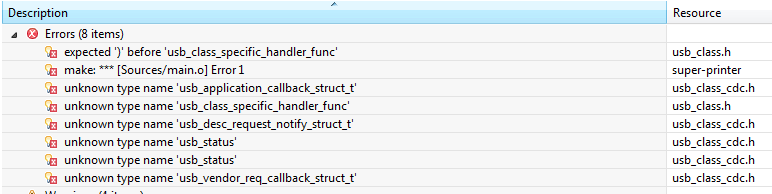

I have a project in KDS that I am trying to get CDC code running on. Bare metal project. I have compiled and included the linker library for the platform, hal, and usbd libraries. I am getting an "unknown type name" error for all the typedefs in usb_device_stack_interface.h. But all the typedefs are being referenced in usb_class_cdc.h, but the usb_device_stack_interface.h is not included in the file. The CDC demo for the frdmk22 board compiles fine for me.
The errors:

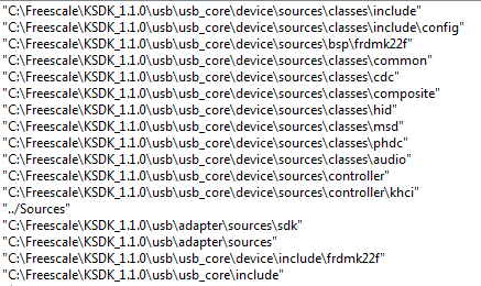

My USB include paths:
The only thing usb_class_cdc.h includes is usb_class.h which includes nothing. Where does it get these typedefs?

Since my last post I have figured out the problem with my compiling error. With KSDK V1.1.0
Many of the USB files use the "_CODE_PTR_" definition but this was not defined anywhere. So I defined it in my project settings.
#define "_CODE_PTR_"     *

A more specific question.
In the KSDK V1.1.0, it has a usb_class.h file. Found in "usb_core\devices\sources\drivers\include". The compile error above "expected ")" before....." is yelling at the "_CODE_PTR" declaration. This is defined in types.h as "*" in the usb stack code as well. But.... usb_class.h does not include any file at all.  How can this code now what "_CODE_PTR" is if it does not include any other file? The example CDC code does not have this defined or undefined in the project settings or anything. Why is it yelling at me?
