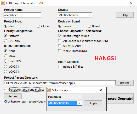

I recently picked up the FRDM-KL82Z board, and found that support for it is not heavily integrated into many packages yet.
What I've found is that the best way to get started is to generate a KSDK project for it.  I downloaded the standalone KL82Z KSDK 1.3, and KSDK Project Generator 2.0.  When I go to generate a project, it hangs forever.  At an attempt to debug this, I've used the project generator with the mainline KSDK (basically has support for every other Freescale chip), and it can generate projects just fine using this.
Is there a bug in the standalone KL82Z KSDK 1.3 that prevents projects from being created?

benjaminschroed
Hi Iva.
Now that I'm looking at it again, I think my issue was I was checking "Generate standalone project".  It wouldn't ever properly generate, and would hang.
3,381 Views
ivadorazinova
Hi Benjamin,
yes - the same result for me.
Thank you for pointing out this! I will report it to Development Team.
Workaround: Please, don´t use Generate standalone project option and generate project to
C:\Freescale\Kinetis SDK 1.3.0 Standalone for KL82Z - Windows\examples\frdmkl82z\user_apps\myProjectKL82Z
it will generate the project into this folder.
Thank you,
Have a great day.
Iva
