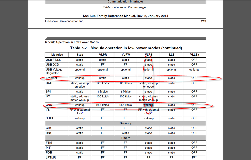

We are currently using KSDK 1.0 with KDS 1.1.1. The application uses FreeRTOS.
To set the application into mode with power manager, mode: kPowerManagerVlps is no problem.
However, we want to wake up the application, either via CAN or Ethernet.
When reading the reference manual for the K64, the wake-up method seems
to be interrupt. Do we need to set the system back into mode: kPowerManagerRun and where do we
place the function call for that?

Hi Anders,
Seems CAN can wake the system up from VLPS mode, so it should be no problem to use CAN module as the wakeup source under VLPS mode, please kindly refer to the following for details.
Hope that helps,
Kan
