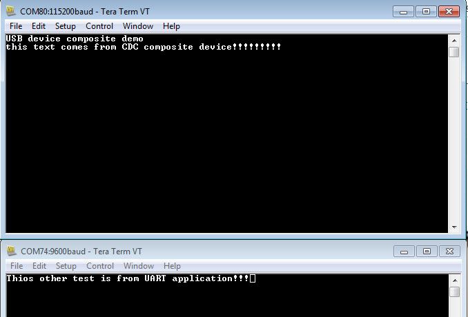

Hi, i am using KSDK, FRDM-K22F and I am new to this.I want to take the data received from Virtual Communication port and then transmit to another UART port in the MSD-CDC example. can anyone please some documents indetail for Device-composite (msd-cdc) example. how to know which UART/USB port is configured for msd and cdc in the source code and what are the changes need to be done to achieve my objective? I need some basics information about this.

isaacavila
Hello padmavathi,
dev_composite_cdc_msc_bm_frdmk22f example included at KSDK 2.0 uses USB OTG module (it only has 1 USB OTG module that is mapped to J16 USB connector) to work as composite MSD-CDC device.
Current CDC application is designed to implement a loopback communication (for more information, you can look to this thread KSDK VCOM example does not work without loopback), so if you want to implement an USB-to-UART brigde you need to implement some modifications on it.
One important thing to consider is that MCU is also connected to K20 (which works as programmer/debugger interface and also emulates a UART-to-USB brige) which implements a CDC class to communicate any terminal (commonly for debug console) to K22 through UART1 that uses PTE0 and PTE1 as TX and RX respectively (see FRDM-K22 schematic for more information), you can use PRINTF function to send to UART1 module (that is connected to K20 and it will send this information to PC through USB) or you can use another UART instance.
So I will use this UART1 instance (that is already initialized at BOARD_InitDebugConsole function) to route the incomming data from USB CDC composite device and viceversa.

Re-compile the project and it should be working
Attach are modified files for your reference!
If something is not clear just let me know it!
