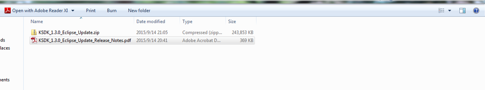

I have KSDK 1.3.0 installed and created a processor expert project. I get this message: This Processor Expert project requires KSDK 1.2.0. How can I make it 1.3.0?

Hi Calvin,
You have to install a patch for ksdk 1.3 at first, the patch file can be found in the folder of C:\Freescale\KSDK_1.3.0\tools\eclipse_update,
Please refer to KSDK_1.3.0_Eclipse_Update_Release_Notes for more details of the installation.
Hope that helps,
