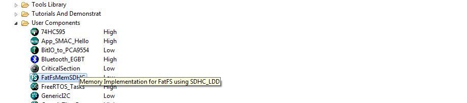

Hi Adrian,
So far, KDS doesn't have PE component for MFS with eSDHC support, just FatFs component, so maybe you can use FatFS instead? Please kindly refer to the following for details.
Kan

Thank you for the information. I searched the internet and found the FatFsMemSDHC you mentioned but when I add it to my processor expert project I get an error.
ERROR: This component is not supported in Kinetis SDK project mode. SDHC1.
Is there a version that is compatible?

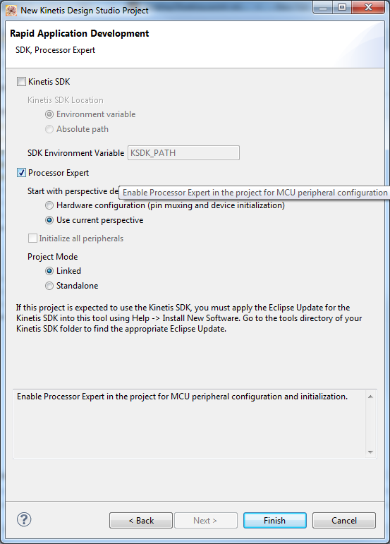

Hi Adrian,
I am sorry this component just support non-KSDK mode, so you have to uncheck the KSDK option in the wizard as below:
Otherwise PEx would report issue, but I am not sure if PEx would add KSDK support for this component in the future, I will check with the software team and let you know when I have any more information.

adyr
Contributor V
Thanks Kan for your suggestion and looking into possible future support for the file system in PEx.
I have created another project without the KSDK as you recommended. I added the FAT_FileSystem and FatFsMemSDHC but when I Generate the processor expert code it fails with:

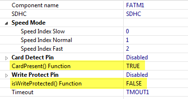

Hi Adrian,
to solve your problem with FATM1_CardPresent(), find attached an update component. It has two new settings which are used if you have CD or WP pins disabled:
You can specify either TRUE, FALSE or a function name. In case of the function name, it will call a prototype like
bool myFunctionName(void);
That way you can provide your own function which tells the driver if the card is present or if it is write protected. That way I hope you have maximum flexibility.
Details of the change on GitHub: support for custom card detection and write protection handling. · 90edd2f · ErichStyger/McuOnEclips...
