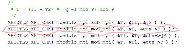

We don't make any limitation on this, LTC of K81 could support keysize up to 2048bit.
For RSA algorithm principle, A, B must be no more than N.
Upon my experience, there have a bug behind the line 406 of rsa.c when you enable CRT function.
See the below picture as reference:
If you also open CRT function, you could try it.

I will apply the suggested fix in the mbedtls_rsa_private function and will test it.
However, please note that the issue I reported is with the RSA key check function and AFAIK there is an updated KSDK version which deals with it and is not related to the K81 capability to handle 2048bit operands in the LTC module. It is the MBEDTLS library which fails to stick to max 2048bit operands.
This issue is detected with keys generated with various PC software and imported in the K81 firmware. It is clearly linked to the size of the key.
