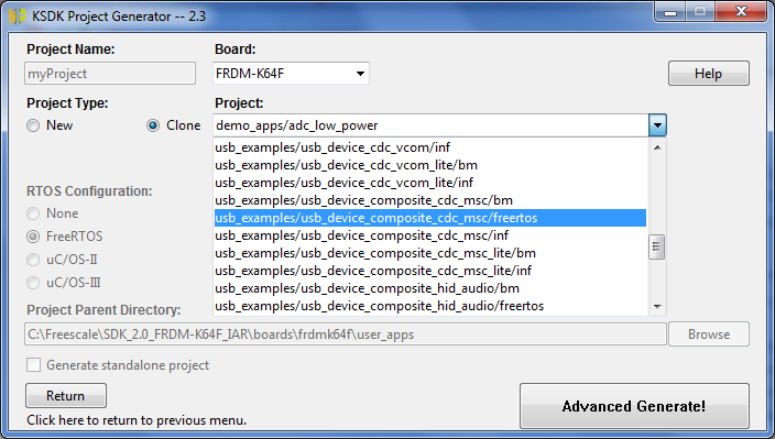

I'm starting an evaluation of K64F using the Freeedom board.
Need to build a project using FreeRTOS and including:
  • USB OTG, initially supporting device-mode CDC
  • TCP/IP and Telnet or SSH
  • later, USB host mode supporting MSD (memory stick for logging, and bootloader SW updates)
A pretty common set of requirements for many of our customers and projects...
Unfortunately the "Project Generator" doesn't display the project names so I cannot read the list
(dope-slap to whomever did the GUI here - see below for too-small drop-down list without horizontal scroll).
What is the best example project to start with to quickly get the above functionality in place?
And how can I find it in this incompletely-displayed list?
Thanks in advance,
Best Regards, Dave

Hi Dave,
First of all, there is no such complex example. Also there is no Telnet example fo KSDK 2.0.
Under older KSDK for MQX
C:\Freescale\KSDK_1.3.0\middleware\tcpip\rtcs\examples\shell
We have separate examples, which you will find under
C:\Freescale\SDK_2.0_FRDM-K64F\boards\frdmk64f
there are also usb examples and  lwip.
C:\Freescale\SDK_2.0_FRDM-K64F\boards\frdmk64f\usb_examples
C:\Freescale\SDK_2.0_FRDM-K64F\boards\frdmk64f\demo_apps\lwip
and needed documentation
C:\Freescale\SDK_2.0_FRDM-K64F_original\docs
The best way is start with some of USB demo and build up your code on this demo (add lwip etc).
At the moment there is newer GUI for Project Generator, v.2.3
Please see https://community.nxp.com/message/841733
I very apologize for the late response.
I hope this helps you.
Iva
