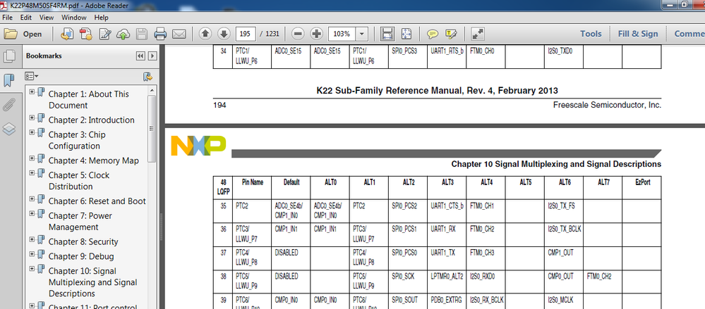

After initializing the Clock management, I try to use PTC3 pin to scope the output of the flash clock to verify the SystemCoreClock is correct.
#define SIM_SCGC5_REG(base) ((base)->SCGC5)
#define SIM_SOPT2_REG(base) ((base)->SOPT2)
#define PORT_PCR_REG(base,index) ((base)->PCR[index])
#define SIM_SOPT2 SIM_SOPT2_REG(SIM)
#define SIM_SCGC5 SIM_SCGC5_REG(SIM)
#define PORTC_PCR3 PORT_PCR_REG(PORTC,3)
#define PORTC_PCR4 PORT_PCR_REG(PORTC,4)
SIM_SCGC5|=0x800;
PORTC_PCR3&=~(0x700);
PORTC_PCR3|=5<<8;
SIM_SOPT2|=2<<5;
I am expecting 16Mhz out for PTC3.  Nothing is coming out.
Any ideas on where I went wrong?
2,653 Views
anbui
Marek,
I just migrated to 2.0 and the new clock tool helped a great deal.  I even used it to reevaluate older 1.3.0 projects.
Xiangjun,
Our package is the  64 pin LQFP.
2,653 Views
xiangjun_rong
Can you tell me the package type of the K22? if you use 121 pins K22, the PTC3 is multiplexed with CLKOUT, of course your code is correct.
But if you use MK22DX128VLF5, MK22DX256VLF5, the PTC3 is not multiplexed with CLKOUT.
Pls have a check.
Xiangjun Rong
