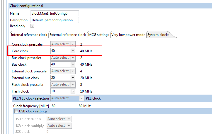

          In properties>clock management>clock settings>clock sources> Select External Oscillator 0 and then external crystal as an additional clock source
          In properties>clock management>clock settings>clock configurations>MCG settings select PEE mode and MCG output to be 80 MHz, Reference clock source should be 'External Clock'
           In properties>clock management>clock settings>clock configurations>System Clocks set core clock and bus clock to 40 MHz, External bus clock to be 20 MHz and the Flash clock to be 10 MHz

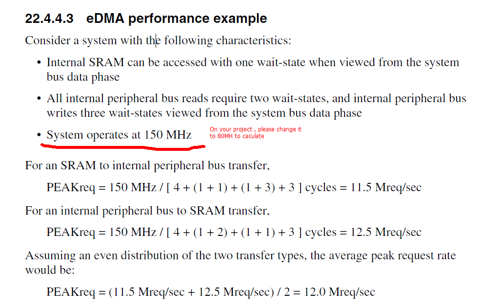

Hello Rose,
For the main speed limit is the DMA speed.
About the detail information please check the 22.4.4.3 eDMA performance example of Reference Manual .
Then after calculate , we can see the clock rate limited  is 6MH .
Hope it helps
Alice

"A 20 mhz 8 bit spi will generate request to the DMA at 20mhz/8bit = 2.5Mreq/sec which is well within the 6Mreq/sec listed here.", yes, you said is right , thank you !
About your project ,i  check one time and one time , you siad your core clock is 80Mhz, while
on the project , you configure it to 40MHZ, this is the reason :
I have test i on my side , after change it to 80MHZ, it can work well .
Alice

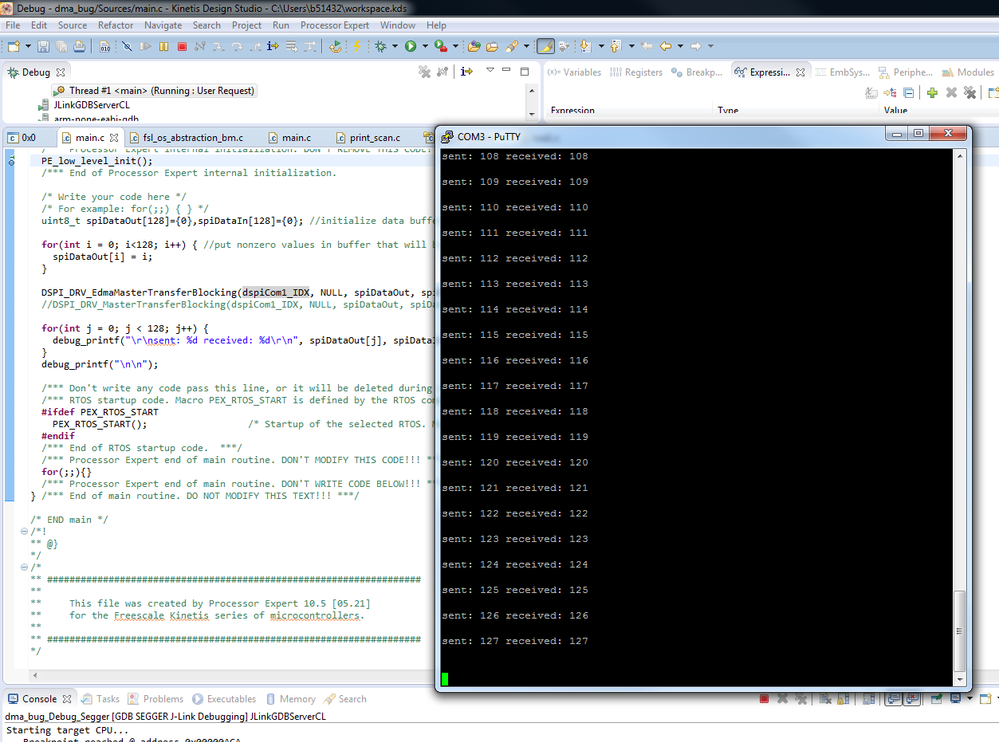

Dear,
I just change the system clock on your project.
On your project you send to me , the system clock is not 80M, it is 40M.
Ok ,  attach the project i changed , and also the result.
Hope it helps
Alice

Hello Rose,
I  have check and test your project on my side,
the clock of SPI is too high , i change it to 10M,
then it can work well .
Hope it hleps
