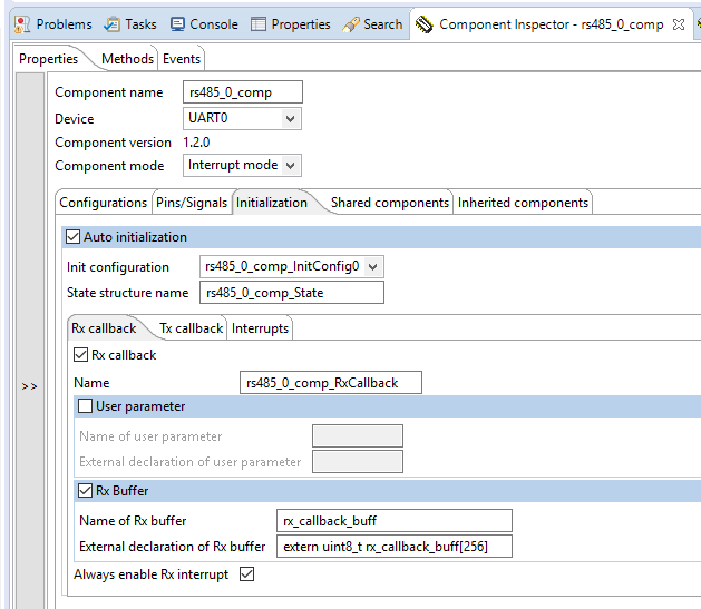

dave408
Senior Contributor II
Hi drew.k​, I know your post is old, but since XiangJun's response wasn't marked as correct, I thought I'd post up a reply.  I had the same problem that you had initially, and in stepping through the SDK, I found the same issue that XiangJun has referred to.
More specifically, to solve this problem in PEx, you just have to specify the buffer.  Here's what mine looks like:
Once you do this and declare the buffer in your code somewhere, the crashing will be resolved.

kyizawwin
Thanks, Dave! This really help me. Not sure why. Could you please share your opinion?

dave408
Hi kyizawwin​, you just have to drill down into the SDK code for the UART driver.  In there, you'll see that it needs to put the incoming data somewhere and wants to write to a buffer.  That's the buffer that gets enabled when you check the checkbox for Rx Buffer and declare it in your code (which is necessary or the array is uninitialized).
5,788 Views
