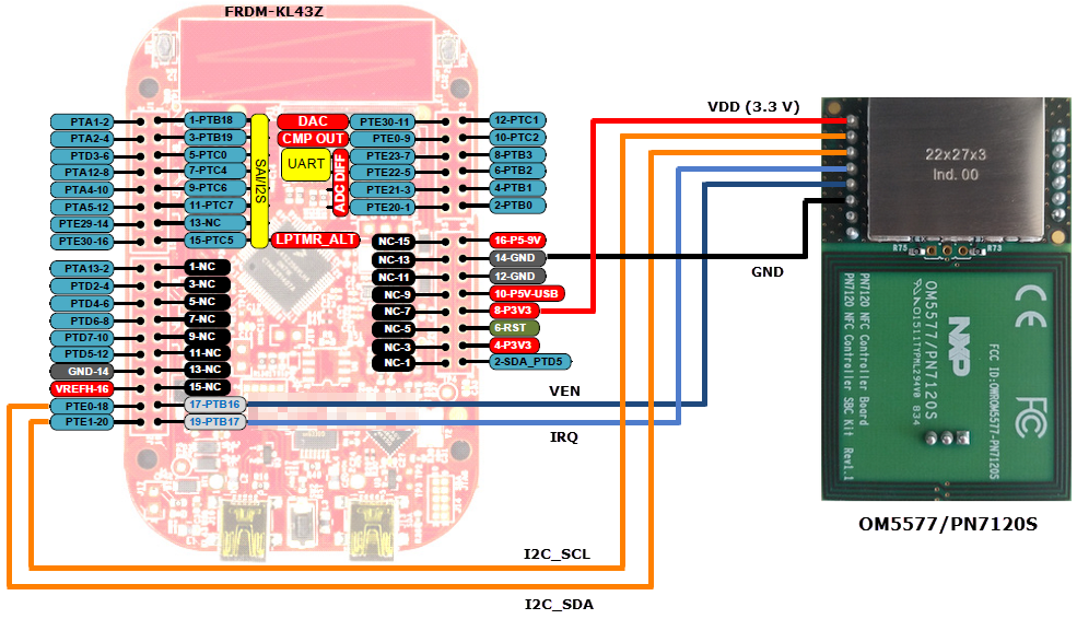

NOTE: In this example the selected pins are PTB16 as IRQ and PTB17 as VEN. The pins depend on your routing from the Kinetis MCU to the NFC Controller board.

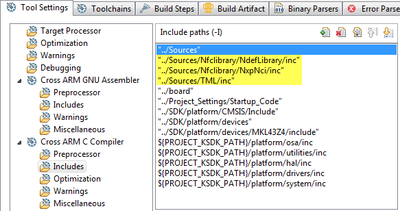

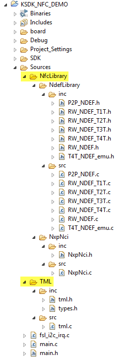

5- Add the NfcLibrary and TML folders with all its subfolders and files to your project's tree, so the library is part of the build. Also add the include paths to your compiler for the inc folders. Below an example with Kinetis Design Studio:
- Now the project is ready to use the NFC controller library. The library uses the next conditional compilation macros, add or remove these symbols from the compiler's preprocessor settings as required:
CARDEMU_SUPPORT: The NFC Controller host (MCU) emulates a contactless card which can be accessed by an external Reader/Writter.
P2P_SUPPORT: The host MCU can establish a 2-way communication accesing to or sending information to an external Reader/Writter.
RW_SUPPORT: With this mode the host can access a remote contactless tag/card via the NFC Controller.
NCI_DEBUG: If defined, all information transfered between the host MCU and the NFC Controller Interface (commands, responses, notifications, data) is echoed to console for debug purposes.

- For the NFC part, I used the NFC Controller board from the OM5577, which is a demonstration kit for the PN7120 NFC controller Interface chip.
- To interface with the NFC Contoller I used a FRDM-KL43Z Freedom board.

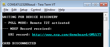

R/W mode:
-  Placing a tag with a single text, URI or vCard NDEF record next to the NFC reader. Examples:

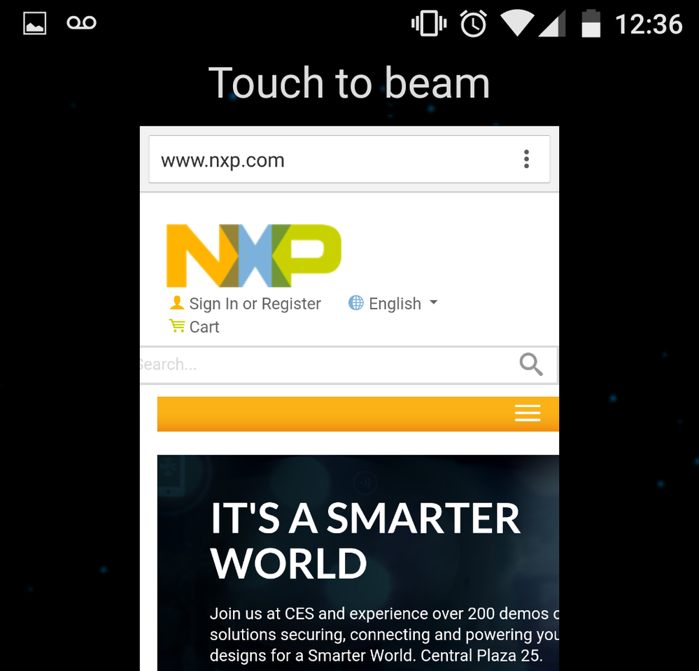

- Bring an android phone with NFC enabled close to the NFC controller antenna and use the "beaming" feature. In the case below the NXP home page is "beamed" from the adroid phone's explorer:

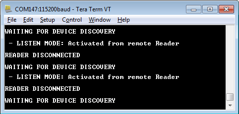

CARD EMULATION mode
  For this mode it is required to remove the P2P_SUPPORT macro and rebuild/reprogram the project.

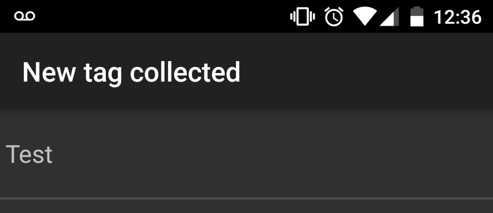

- Bringing an android phone set to read a NFC tag close to the NFC controller board:

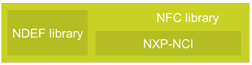

- In many project examples where PN7120 and NCI is used for kinetis, this image is provided from corresponding application note;
but my question is, where can I get such library from? The ported library for the examples (e.g. NXP-NCI Kinetis Design Studio example) is a reduced NCI library; where is the complete library? The full library is the "linux_libnfc-nci"? So when I want to use it in a Kinetis microcontroller it must be ported? My case is: I want to have the full NFC NCI library in a KL26 microcontroller and not in an android device, how can I do it? Is there any ported version of the full NCI library for microcontrollers?

The library referenced from the image in the application note is actually the one available in the NXP-NCI KDS example or in the example project in this document. That library provides the primary functionality to start a development with the PN71xx family of NFC Controllers. By the way there is a new version of this community document in the next link, to use the Arduino interface kits:
https://community.nxp.com/docs/DOC-331907
The libnfc-nci libraries for Android and Linux indeed provide some more advanced APIs but the code is not suitable to be used in a general purpose MCU. If you require some function from those libraries you need to implement it on top of the existing Kinetis NXP-NCI library.
