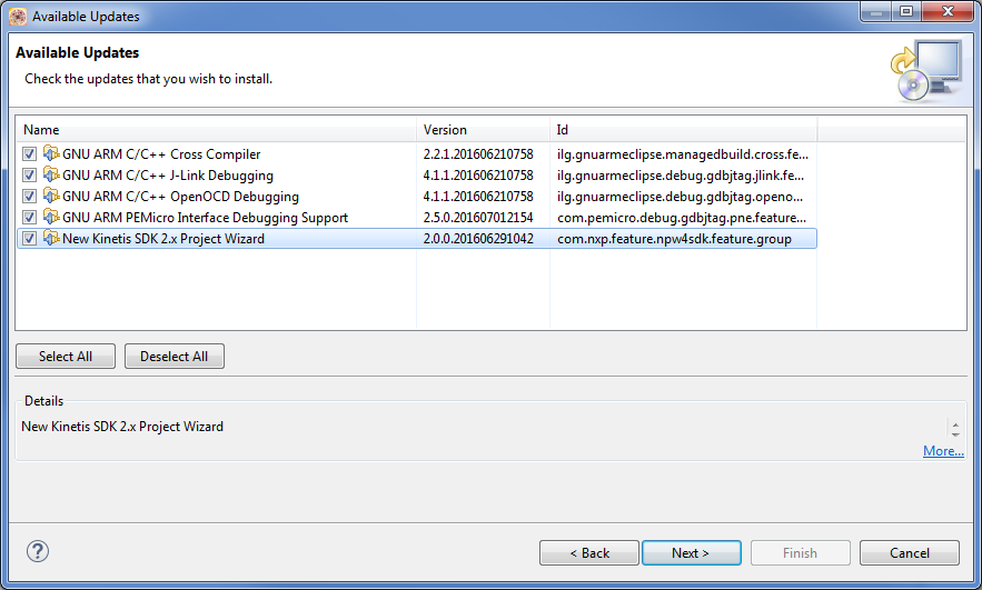

guilhermebaggio
Efetuei o download do KSDK da FRDM-KL27Z e ao tentar instalar pelo Help > Install New Software recebo a seguinte mensagem: "No software site found at jar:file:C:/Users/Guilherme/Downloads/SDK_2.0_FRDM-KL27Z.zip!/". Como proceder?

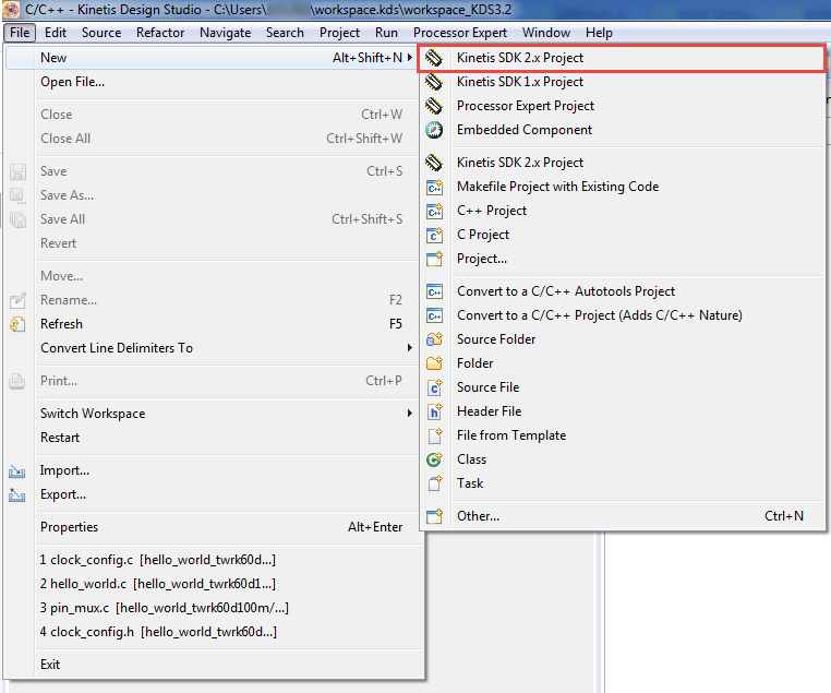

- To Create new project with the wizard:
  1. Start Kinetis Design Studio
  2. Select the menu File > New  > C Project
  3. Enter project name and select "Executable - Kinetis Project for SDK 2.x" and press [Next>]
  4. Select where you have unzipped the SDK package from previous step and press [Next>]
  5. Select board or processor and press [Next>]
  6. Finish wizard
- Now you can build and debug your project

Hi Guilherme,
first we need to know which version of SDK you use. If it is KSDK 1.3.0 then unpack the .zip and forward SDK_2.0_FRDM-KL27Z/tools/<exclipse_update/SDK_1.3.0_FRDM-KL27Z_1.0.0_Eclipse_update.zip> to the path. If it is a KSDK 2.0 then use the newest Kinetis Design Studio and select File -  New - KSDK 2.x project.

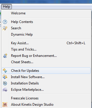

ivadorazinova
Hi Guilherme Baggio,
please have you installed update for KSDK 2.0?
I mean Help -> Check for Updates
New Kinetis SDK 2.x Project Wizard and click on Next and install the update
after successful installation you will see Kinetis SDK 2.x Project Wizard in File -> New
Please let me know, if you solve your issue.
Iva
