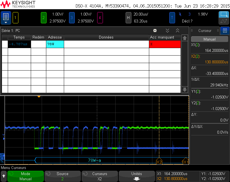

Hello Freescale community,
I use Kinetis Design studio 2.0.0, MQX KSDK 1.0.0 with Processor expert, (uc MK64F),
I realized I2C communication using I2C0 as Master.
I talk with a eeprom in a Task every 50ms, when I want to talk with the Eeprom, if it is not present on the bus, I receive a NAK but the signal STOP is not send and the driver return :  I2C_Fail
You can see the behavior in the following screenshot :
I use the function :  i2c_status_t    I2C_DRV_MasterReceiveDataBlocking
To solve the problem I add this condition (indicate in RED) in the function I2C_DRV_MasterReceiveDataBlocking :

It is normal to have to add this condition  ?
1,588 Views
Jorge_Gonzalez
Hello PE TAPIE:
That is a bug with KSDK v1.0.0, which is fixed in the latest versions. Attached you can find the relevant I2C driver and HAL from KSDK v1.2 so you can compare the differences, but I highly recommend you to migrate to KDS v3.0.0 and KSDK v1.2.0.

tapiepierre
Hello Jorge Gonzalez,
Thanks for you answer,
I looked at the differences beetween the two drivers and effectively the new works as expected
thanks,
