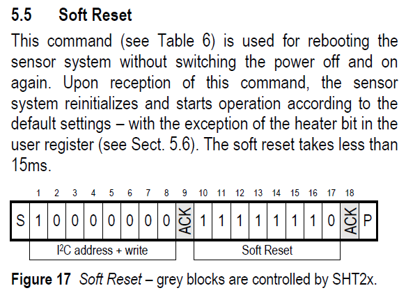

I'm using a Sensirion SHT 21 (datasheet).
One of the command available is to send a soft reset (easily explained via screen shot from the data sheet).

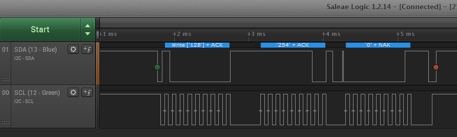

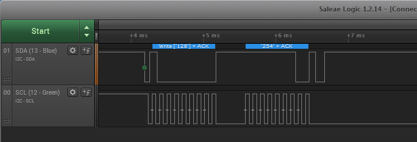

This doesn't' send a stop command and leaves SCL low:
If I add in some dummy data and send a send it (i.e. i2c_soft_reset.dataSize is not set to zero) the an I2C stop is correctly sent.

This gives

Hi Ben,
For the I2C driver to work properly (ie, send stop to complete transfer), at least 1 data byte need to be there, when using a subaddress. So, for transmitting only 1 data byte (as in your case), use data to send the byte and give no subaddress. Like this:
  i2c_soft_reset.slaveAddress = SENSIRION_I2C_ADDRESS;
  i2c_soft_reset.direction = kI2C_Write;
  i2c_soft_reset.subaddress = 0;
  i2c_soft_reset.subaddressSize = 0;
  i2c_soft_reset.data = SHT_SOFT_RESET;
  i2c_soft_reset.dataSize = 1;
  i2c_soft_reset.flags = kI2C_TransferDefaultFlag;
