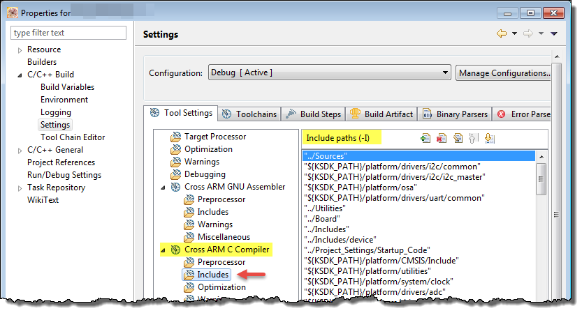

Maybe this is a better question to ask since these functions are included in the KSDK files in my includes already. I seem to have issues with include files not showing up when I compile, and I assume this has something to do with my linker or include settings, because with some things, simply declaring #include "X" or "include <X> leads to errors. Is there a common method to fix this, or have these files more easily recognized? I attribute this to lack of understanding with Eclipse, but I am hoping you can point me to a resource or tutorial that help me develop my understanding of how the backend of this IDE works.
Thanks.
3,754 Views
Jorge_Gonzalez
Hi Donald:
If trying to include any header file, make sure the corresponding path is added to Project -> Properties -> C/C++ Build -> Settings -> Cross ARM C Compiler -> Includes:
If you are not familiar with Eclipse then it is highly recommended that you visit MCU on Eclipse | Everything on Eclipse, Microcontrollers and Software. This site is maintained by colleague Erich Styger and has lots of tutorials about Eclipse and Embedded Systems in general.
Regards!
Jorge Gonzalez
