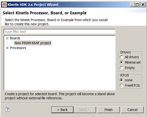

How I can use scanf in baremetal project, using "Drivers minimal set"  printf is working at 11520 boud.
I'm using KDS v3.2, KSDK v2.0 and FRDM-K64f

Using KSDK v2 to be able to use debug_console you have to create project using "project wizard" that at least will include "Drivers Minimal set" configuration (no Empty).
In this case "printf()" (which is supported by <stdio.h>) statement is working without using
#include "fsl_debug_console.h".
But only printf(), other stdio statemens like  scanf(), getc() and putc() doesn’t work.
To get similar function I have to #include "fsl_debug_console.h" and use  SCANF(), PUTCHAR() and GETCHAR() equivalent functions.
This is what I wanted to confirm.
Shaul
