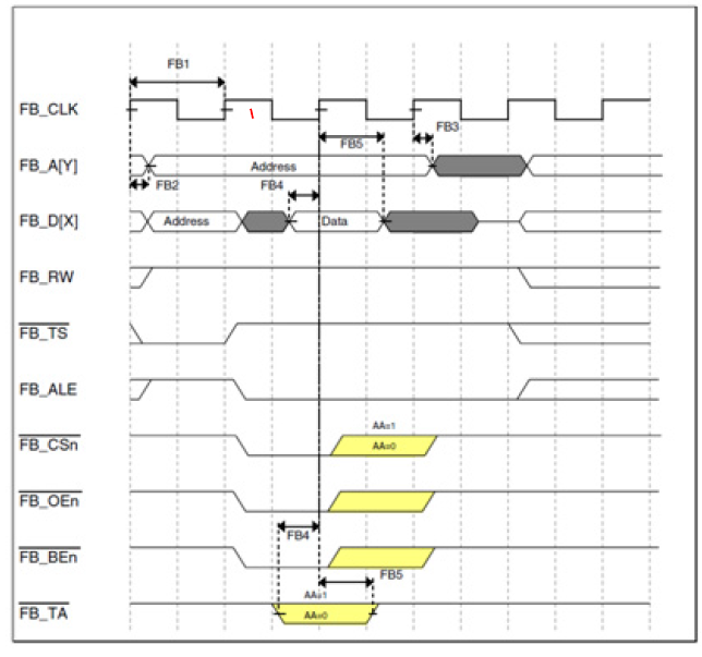

    Now I want to use flexbus to config the fpga; i can't find design demo of flexbus;only the driver
flexbus_config_t flexbusConfig;
FLEXBUS_GetDefaultConfig(&flexbusConfig);
flexbusConfig.waitStates = 2U;
flexbusConfig.chipBaseAddress = 0x60000000U;
flexbusConfig.chipBaseAddressMask = 7U;
FLEXBUS_Init(FB, &flexbusConfig);
I  use the demo config the flexbus;but i can't measure

  I read the date from the fpga;the flexbus  address is 0x8003,the date is 0x77.
But i read the date is 0x17.I don't kown why ? where is the 0x17 come from?
The _51RDLVT is FB_OE.
Thanks and best regards
zhai

Does the timing is from logic analyzer or tools of FPGA, I think it is possible that the data become from 0x77 to 0x17, when  the FB_OE becomes high, which means that the FPGA do not drive the data bus, in other words, the data bus is float when  the FB_OE becomes high.

  Yes,I grab the signal with the signaltap ii; The date of  fpga send is always 0x77;when  the FB_OE becomes high ,the date shoud be 0x77;
my configrations
void FLEXBUS_GetDefaultConfig(flexbus_config_t *config)
config->chip = 0; /* Chip 0 FlexBus for validation */
config->writeProtect = 0; /* Write accesses are allowed */
config->burstWrite = 0; /* Burst-Write disable */
config->burstRead = 0; /* Burst-Read disable */
config->byteEnableMode = 0; /* Byte-Enable mode is asserted for data write only */
config->autoAcknowledge = true; /* Auto-Acknowledge enable */
config->extendTransferAddress = 0; /* Extend transfer start/extend address latch disable */
config->secondaryWaitStates = 0; /* Secondary wait state disable */
config->byteLaneShift =kFLEXBUS_Shifted;//kFLEXBUS_NotShifted; /* Byte-Lane shift disable */
config->writeAddressHold = kFLEXBUS_Hold1Cycle; /* Write address hold 1 cycles */
config->readAddressHold = kFLEXBUS_Hold2Or1Cycles; /* Read address hold 0 cycles */
config->addressSetup =
kFLEXBUS_FirstRisingEdge; /* Assert ~FB_CSn on the first rising clock edge after the address is asserted */
config->portSize = kFLEXBUS_1Byte; /* 1 byte port size of transfer */
config->group1MultiplexControl = kFLEXBUS_MultiplexGroup1_FB_ALE; /* FB_ALE */
config->group2MultiplexControl = kFLEXBUS_MultiplexGroup2_FB_CS4; /* FB_CS4 */
config->group3MultiplexControl = kFLEXBUS_MultiplexGroup3_FB_CS5; /* FB_CS5 */
config->group4MultiplexControl = kFLEXBUS_MultiplexGroup4_FB_TBST; /* FB_TBST */
config->group5MultiplexControl = kFLEXBUS_MultiplexGroup5_FB_TA; /* FB_TA */
The minmum time of FB5 shuld be  0.5 ns.Is it the reasion to make it? How to adujst it?
Thanks and best regards!
