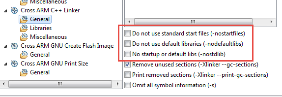

BlackNight
It is a problem of your linker settings. You have both -nostartfiles and -nodefaultlibs enabled, so the linker does not link with the standard libraries (which include the math functions).
Try these settings:
I hope this helps,
Erich

homarpizar
I tried as you show me,
But now it is shown:

BlackNight
It seems that this MQX project somehow has additional dependency e.g. on some I/O functions.
I see you have
-lnosys
in your linker flags: try to remove that option and instead link with the system library?
