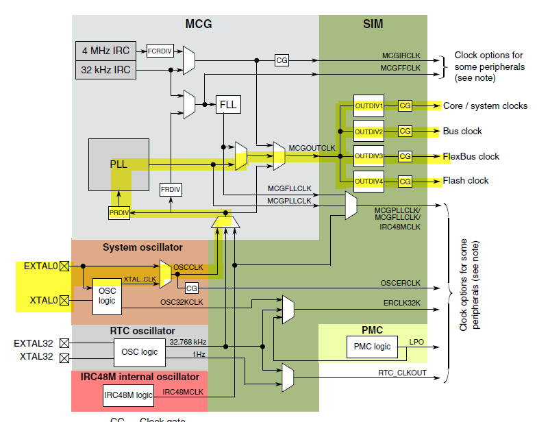

I'm porting a firmware running on a custom board from KSDK 1.3 to KSDK 2.1. I use Kinetis MK64FN1M0VLQ12 clocked with a 12.288 MHz crystal. With KSDK 1.3 the firmware works fine. With KSDK 2.1 I am not able to correctly setup clock.

firmware hangs in CLOCK_BootToPeeMode().
I want to make this clock path:
where am I wrong?
best regards
Max

Hi Max,
there is available Clocks tool on http://mcuxpresso.nxp.com/ that can generate clock tool initialization code for you. This might help. The tool is available both as WEB version and also as DESKTOP version.
Marek
