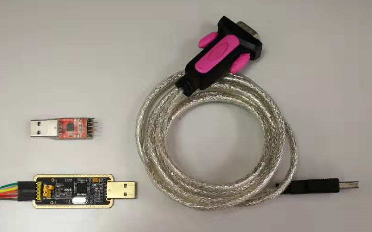

I try to test FTDI232 USB to Serial tool, while I test below three types without success.
The TWR-K21F120MA serial terminal shows "device not supported."
So I test with FRDM-K64 board with USB CDC device routine, which can pass the test.

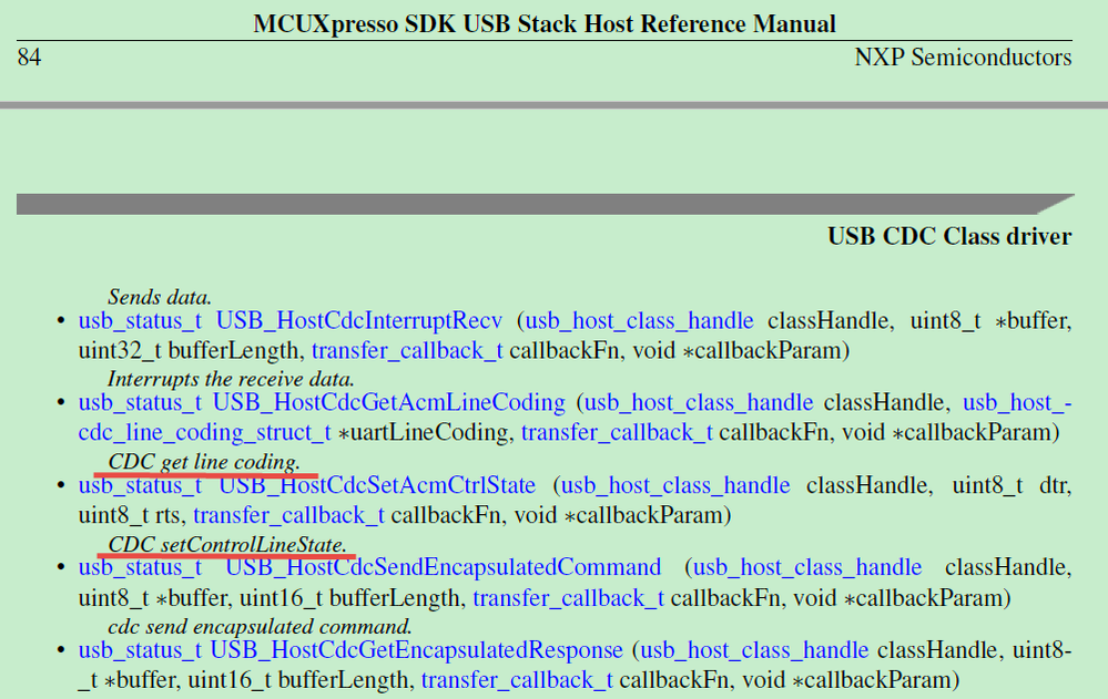

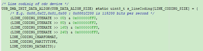

I could find below USB CDC device line coding at <virtual_com.c>
The macro definition located at <virtual_com.h> file
I checked the USB CDC Host driver at <usb_host_cdc.c> file, there without provide API function to SET_LINE_CODING. That's why customer can't change USB CDC device baud rate.
Thank you for the attention.
