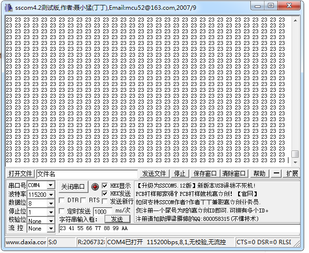

   Now I want to send and recieve vary date in uart4.
for example:
 I recieve 8 byte date through uart4; I want to send demoRingBuffer[0] only one time.
how to chang it?
My configrations:
It always send 0x23; I want to send only one time.How to chang it?

Hi, Zhao,
Regarding your code, that you want to output an array only once, you can change code cas follwoing:

zhailing
  I test your code,the rusult is the same to mine; I want to get 8 byte date from the uart rx ;
I will implent  other function through  the uart command and output command to upper machine.
Actualy I want to use the uart fifo function,But I don't have demo code.
zhai
