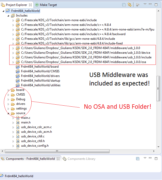

Thanks for your reply. That was my first try when I started trying to bring USB CDC to my code (I have included USB Middleware to my project, in my case I've used absolute path to my KSDK location and I have copied the usb files specific to project to my project - usd_device_cdc_acm.c/h, usb_device_ch9.c/h ...). I also needed to included  a SYMBOL "USB_STACK_BM" since I'm not using any SO and make the necessary included of code into my main file. All of this was pretty straight and compiled fine, but the problems started with Linker! The Linker can't find object code from USB Stack unless I create a virtual reference to them into my project and that where I thought I was doing something odd. Observe that the simple fact of include USB middleware doesn't create the USB folder structure that you pointed into your first picture.
By the issue reported by Linker it seems that USB stack object code couldn't be found.
Again, the only way that I could solve it was creating a virtual reference to OSA and some USB files from stack. When I did it, the folder is showed on my structure (with a while little square on its icon) and the object code was created and linked fine.

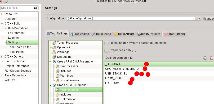

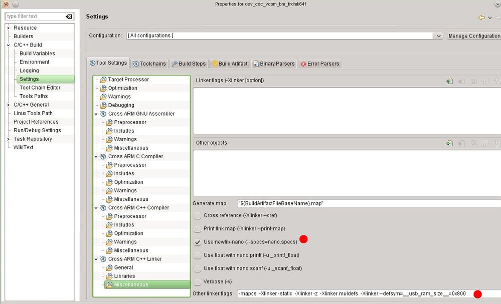

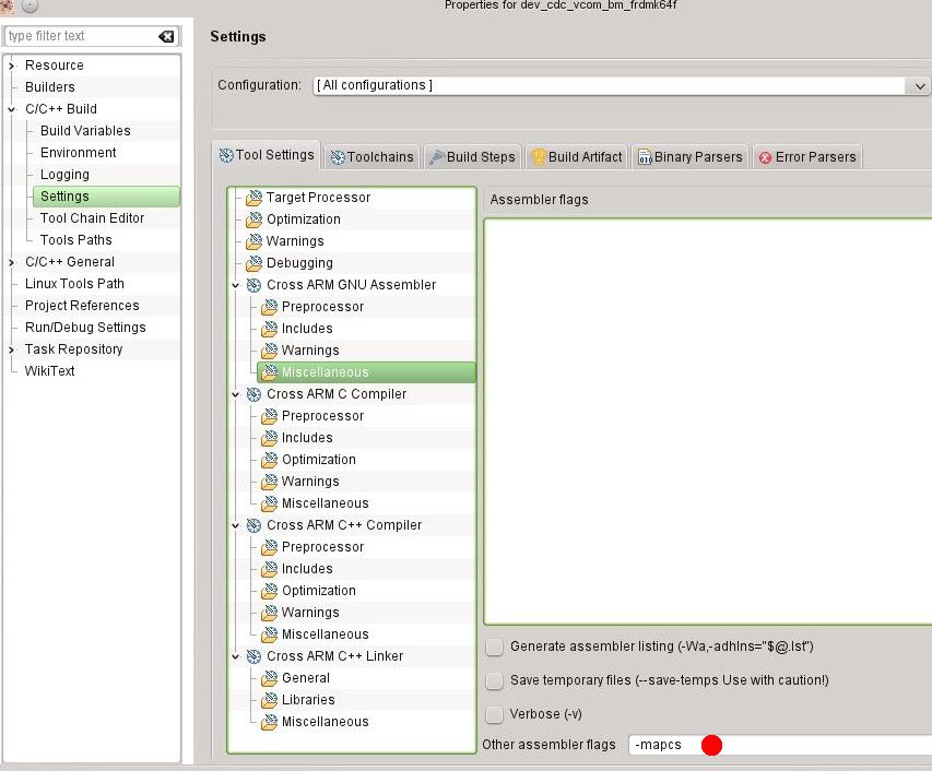

However, even after I set the numerous include paths (the header files are spread over many directories! :-(( , the USB would still not function. I have one hint now: In the example project there are quite a few special toolchain settings, like
--STARTUP_CLEAR_BSS,
-mapcs,
-DUSB_STACK_BM
etc.etc.
How can I get these into my existing project without writing them down on paper one by one and re-entering them in corresponding fields in my own project settings? I looked at the ".cproject" XML file, but it seems not feasible to edit it directly.
Any idea is very welcome
Gerhard
3,595 Views
gerhardheinzel

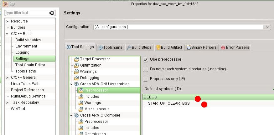

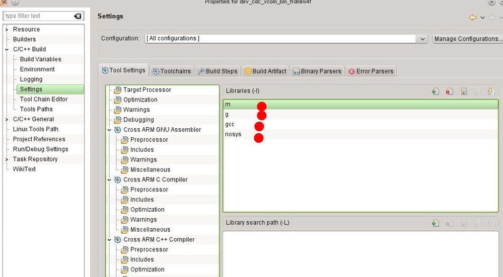

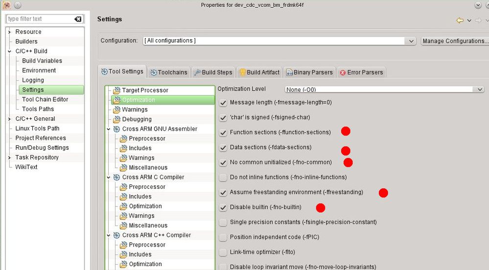

 Below are some of the settings of the working example project that differ from the standard settings of a new SDK2.0 project.
Some of them seem essential to get the USB to run.
It took me a long time to find this out; it would be very helpful is this were written somewhere, e.g. in the README file of the example project.

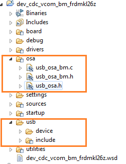

You need to include the middleware in your project configuration, you could use the example code as reference, I will use the kl26z to show how to do it. Next image show the structure and the needed files for usb cdc vcom example:
Some of them can be found in the middleware and others are more app specific so are located in the example path.

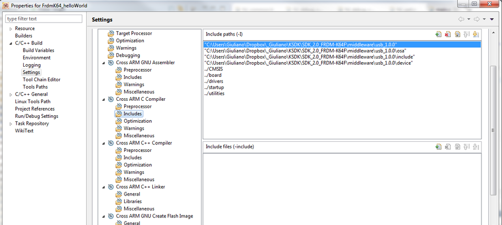

In the example project properties->C/C++ Build->Settings->C Compiler-> includes you can see the needed paths for the usb example are:
these "../../../" are relative paths for the location of the example project, but in your case you can use something like {your_path_SDK_2.0_FRDM-KL26Z}\middleware\usb_1.1.0
If you check the example code location:
{SDK_2.0_FRDM-KL26Z_paths}\boards\frdmkl26z\usb_examples\usb_device_cdc_vcom\bm
you can find the other files that you need:
so you will also need add them to the includes paths, I recommend you to copy this files and place them into your project path and then include them in your paths.
