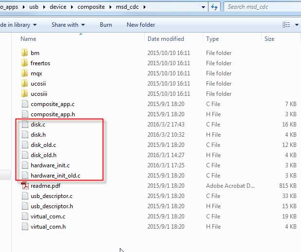

  • Change usb\example\device\composite\msd_cdc\disk.c as attached file
     Change usb\example\device\composite\msd_cdc\disk.h as attached file
     Change usb\example\device\composite\msd_cdc\hardware_init.c as attached file.

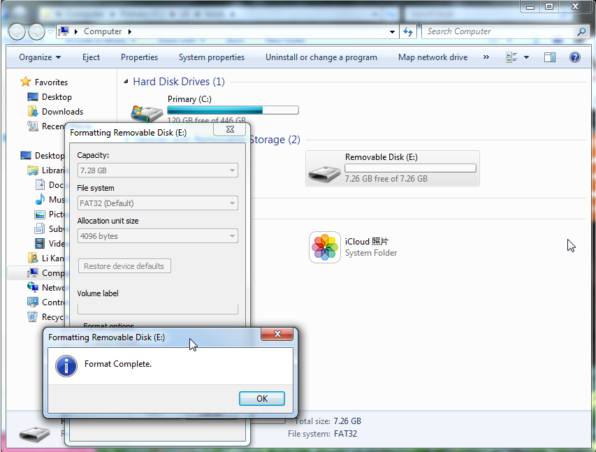

With SD card inserted , you may see the removable disk, and format the disk just like below:

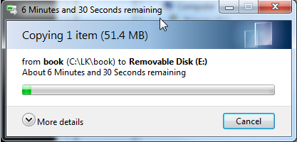

Copy a ~50M file to this disk
eject the disk after done, and then pull and plug the device again, you may verify the copied file with fc.exe command
