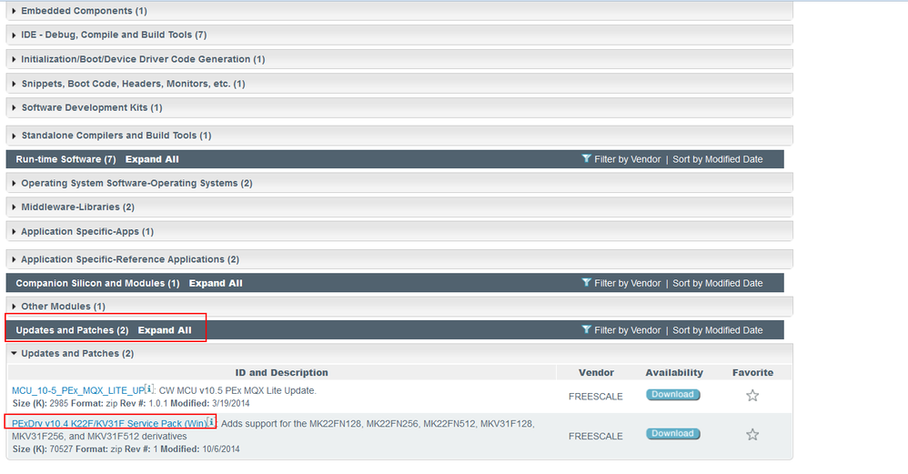

Hello Josh,
From your this words "(it forces you to use kinetis sdk)"  , if you want use PE without SDK,  you can update a patch (KV3x |Kinetis KV3x BLCD MCUs|Freescale)  in KDS. (update step you can refer to the document of  attchment  , the "Updating Offline" part ).
This patch:

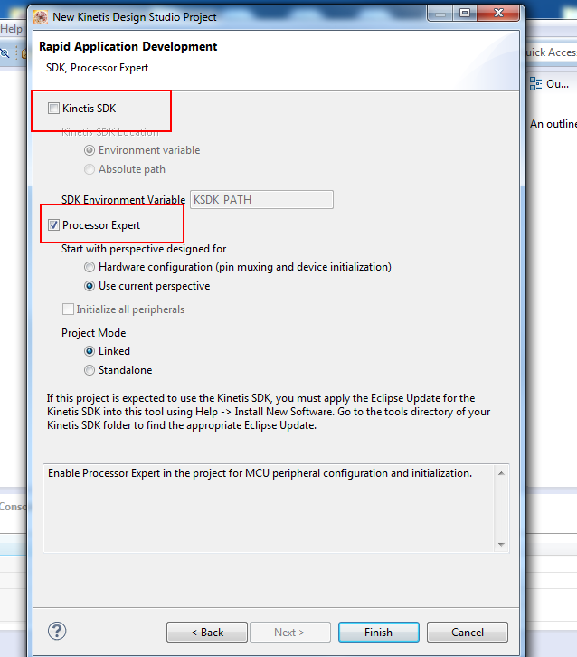

After updated ,  when you create project chose like this :
And i will continue check the interrupt files of SDK .
