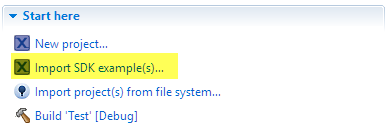

I recommend that you have a look at the NXP MCUXpresso IDE, see MCUXpresso IDE: Unified Eclipse IDE for NXPs ARM Cortex-M Microcontrollers | MCU on Eclipse  and especially the 'New Project' section. What the NXP MCUXpresso IDE has is the ability to import/clone an existing SDK example project with a new name:
Use the Import function:

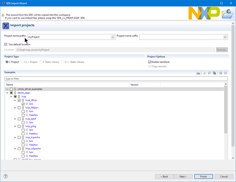

Select the Board/SDK:
Then select the projec(s) and give it a name:
This then clones an existing SDK project under a new name.
