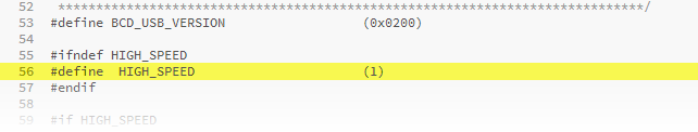

Title says it all: does the SDK v1.3 with MQX support high speed USB on the K66 ( or K65 ) ?

Hi George.
Yes exactly. Both K65 and K66 have this capability USB High Speed.
But in KSDK 1.3 is supported only K65. Not K66.
If you go to the header file at C:\Freescale\KSDK_1.3.0\examples\twrk65f180m\demo_apps\usb\device\msd\usb_descriptor.h here you should enable the macro HIGH_SPEED     1
I hope this helps.
