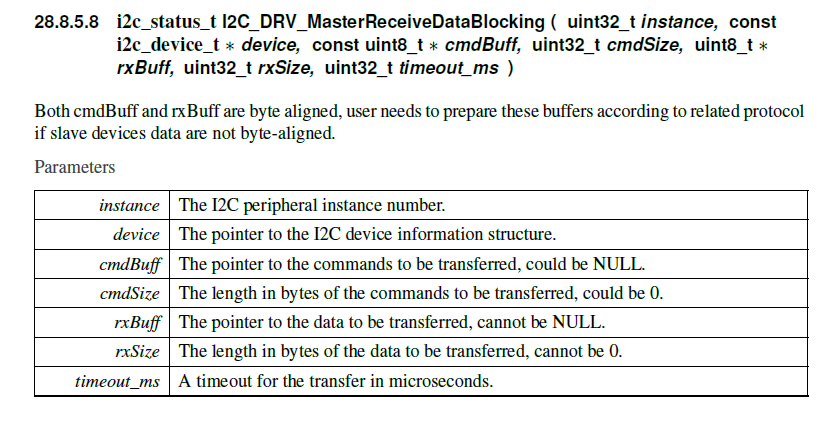

Regarding your question about the api function parameters declaration, pls refer to IIC driver description in chaper 28.7 I2C HAL driver in the Kinetis_SDK v1.3 API Reference Manual.pdf. I copy it here.
We have also example for the master mode of IIC. refer to the example in SDK:
D:\Freescale\KSDK_1.3.0\examples\frdmk64f\driver_examples\i2c\i2c_blocking\master\kds
Foe the parameter of api function:
  1. i2c_status_t I2C_DRV_MasterReceiveDataBlocking(uint32_t instance,
  2. const i2c_device_t * device,
  3. const uint8_t * cmdBuff,
  4.                                                uint32_t cmdSize,
  5.                                                uint8_t * rxBuff,
  6.                                                uint32_t rxSize,
  7.                                                uint32_t timeout_ms);
The instance is the index of IIC module, for example, the processor has 3 IIC module: IIC0/IIC1/IIC2, if you use IIC0 module, the instance is 0, if you use IIC1 module, the instance is 1.

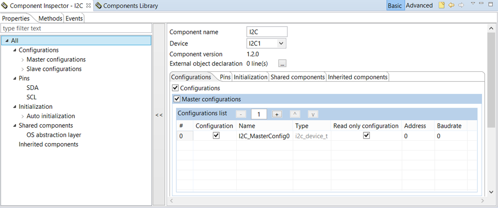

Firstly I defined my I2C:
with my SDL/SDA pins:
