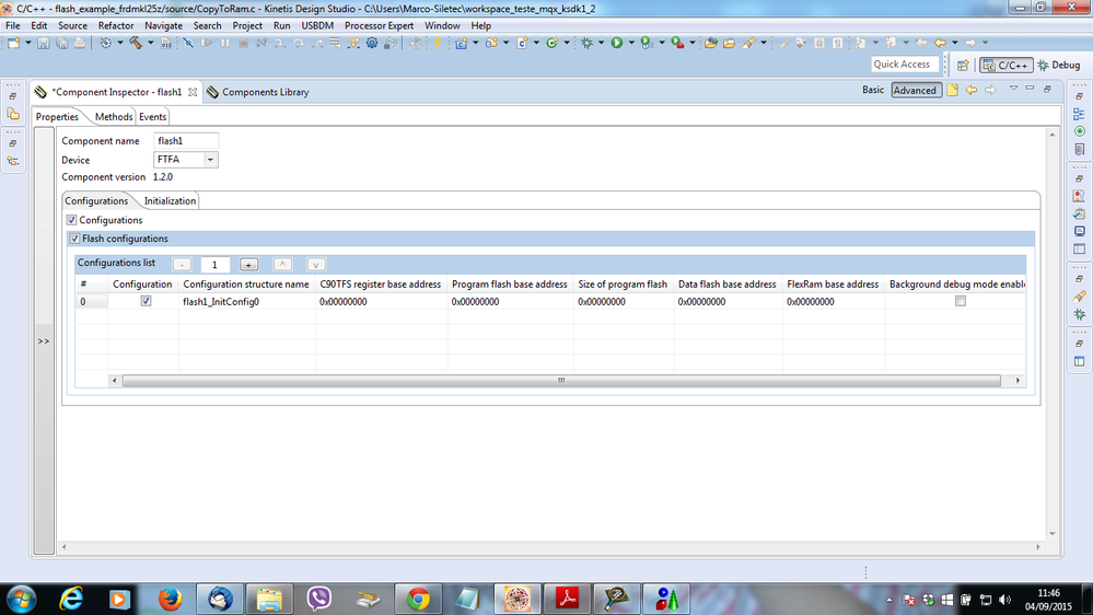

One of the features of the project is programming data in Flash. There is a manual explaining the KSDK 1.2 Flash driver functions and a demo, as well. But we haven't found a manual for the new KDS 3.0 Processor Expert and its beans, that are completely different from CodeWarrior 10.x ones. So we are in a struggle to learn how to use it.
One thing that called our attention is C90TFS register base address setting. We looked at the MKL25 reference manual for some information about this register, but we couldn't find absolutely nothing. Another find that we can't understand is why we need to define in this bean parameters like Program Flash base address and Program Flash size, since the MCU is defined through the CPU bean?
We need guidelines or examples on how to correctly configure and use this bean.

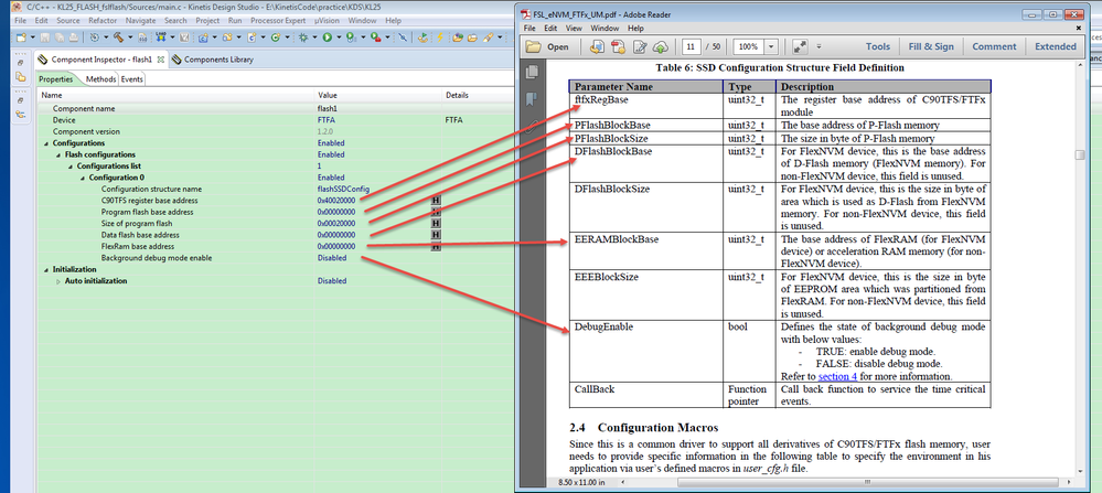

        fsl_flash bean in KDS 3.0 is really very different from the FLASH_LDD in CW.
      fsl_flash bean is the component for flash driver C90TFS, so the configuration should define the C90TFS items, then use the API function in C90TFS to operation the flash.
About the configuration items in fsl_flash,  please refer to the following picture:
It is very sample, so there has no guidance now, the above configuration is for MKL25Z128, it is just define the data for the SSD structure in C90TFS.

After the configuration in the above picture, you will get this struct:
FLASH_SSD_CONFIG flashSSDConfig = {
    .ftfxRegBase = 1073872896U,
    .PFlashBase  = 0U,
    .PFlashSize  = 131072U,
    .DFlashBase  = 0U,
    .DFlashSize  = 0x00U,
    .EERAMBase  = 0U,
    .EEESize    = 0x00U,
    .DebugEnable        = false,
    .CallBack = NULL_CALLBACK,
ftfxRegBase is KL25 FTFA register base address, you can find it from KL25 reference manual,  it is 0X40020000
PFlashBlockBase = PFlashBase Pflash base address is 0x00000000;
PFlashBlockSize = PFlashSize ,  the block size of KL25, as you know KL25 have 128KB flash, so the size is 128KB= 0x00020000= 131072U
No data flash, so DflashBase =0, DFlashSize =0;
No FlexNVM, so EERAMBase =0, EEESize =0;
For more details about C90TFS, I think you can refer to the attached C90TFS document:
After you configure it, you can refer to the code in KSDK1.2.0 to write the flash code.

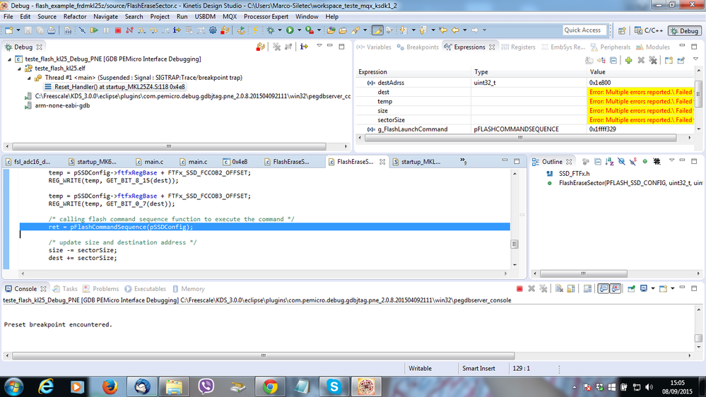

I debugged my code and some points called my attention:
1) In "FlashEraseSector", after it goes through the line:
        REG_WRITE(temp, FTFx_SSD_FSTAT_ERROR_BITS);
The "dest" variable, that had the value "0x1E800, assumes the value 0x31. Another point that you can see by hte screenshot bellow is that "temp" variable is not accessible at any time. So strange!

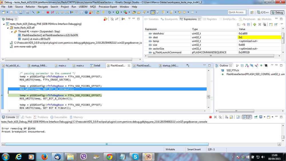

2) After it goes through the line:
        REG_WRITE(temp, GET_BIT_16_23(dest));
"dest" variable assumes the value 0x01, as you can see on the screenshot bellow:
3)   After that, it goes into a strange loop as if there is a for loop from the line:
        ret = pFlashCommandSequence(pSSDConfig);
to the line:
     dest += sectorSize;
    And does it for some times until it calls "pFlashCommandSequence" for a last time and falls into a Reset that I can't recognize the cause.
Jingjing, please have attached my code. Could you take a look at it and help understand where I went wrong?
