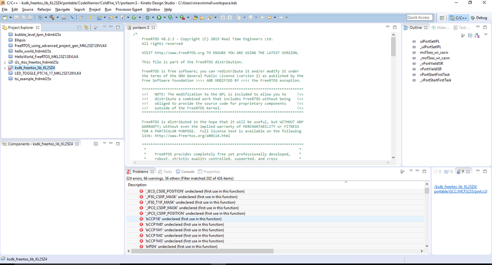

2) Kindly check the attachment screenshot. After I followed all the steps from the above video, I still get many errors. Do you have any idea?
Nirav
6,009 Views
ivadorazinova
Hi Nirav,
it is because you don´t forget import some library necessary for example project. It is easier.

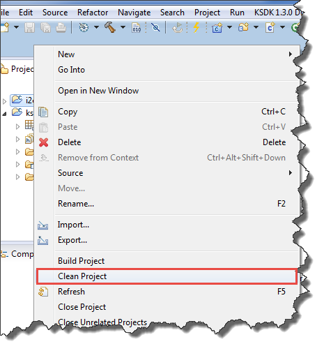

Please, have you cleaned your project and built again?
Iva
6,009 Views

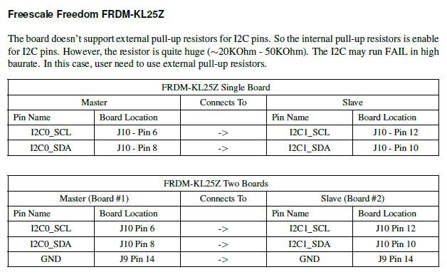

Please, check these examples:
I2C Demo with RTOS located under <SDK_Install>/examples/<board>/demo_apps/i2c_rtos/<rtos>/<toolchain>
For more details please refer to KSDK v1.3 Demo Applications User´s Guide
there are also information about pins connection for each device.
Power Manager RTOS Demo located under <SDK_Install>/examples/<board>/demo_apps/power_manager_rtos_-demo/<configuration>/<toolchain>
with these supported low power modes for KL25Z
I hope this helps.
