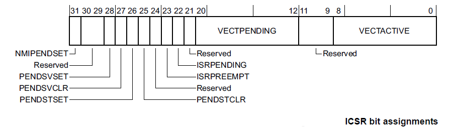

Hello Massimiliano Sturla:
If the default handler is launched by an interrupt which does not have a Service Routine defined, then you can know which interrupt triggered it by checking the ICSR register, at address 0xE000ED04. Below the bit assignment:
In this case the VECTACTIVE space would tell you the interrupt vector number.
Otherwise, if the cause is a hardfault, then it is not as easy. You need to have a dedicated handler to help you track the offending instruction. Check the next post by colleague Derek Snell and the links provided by him:
Tracking down Hard Faults
I hope this helps.

Ok, many thanks!
i will try as soon as possible to track hard faults.
For ISR I willl check ICSR
Many thanks,
