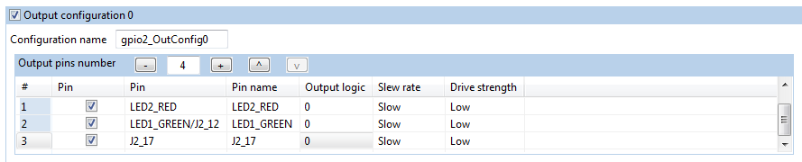

I'm using the frdm-kl43z board and trying to control a simple output with processor expert.
I am able to do so with the on board LEDs, but when trying to output a voltage with the pins, I can't toggle an output.
I've configured several pins in processor expert but get nothing out.
these are the configurations of LEDs and J2_17:
I've also tried an output logic of 1 and various combinations of slew rate and drive strength.

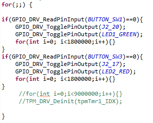

This is my code to control a simple toggle of the output with the on board buttons.
It works fine with the LEDs but not with the Pins.
