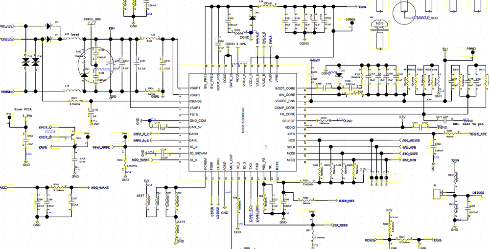

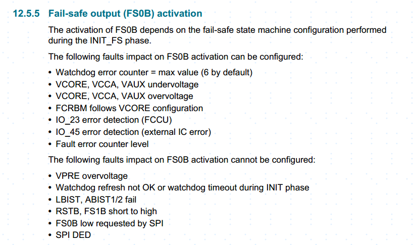

Hi,Sun
Now, my Fs6503 feed the dog has been normal, I use in my schematic FS0B this pin to control my contactor, at first I didn't notice this place, this pin as long as electricity output low level, whether in the debug mode or normal mode, so that I contact directly is locked, can you help me points for this reason?I have checked the reasons why FS0B may be pulled down in the manual, as shown in the following pictures. I have confirmed that there are no problems with the first three, and the remaining ones are all in a vague state. Please analyze the reasons in combination with my schematic diagram.
Maybe I should ask you how I can pull the FS0B pin higher after the initialization of the fs6503 is complete.

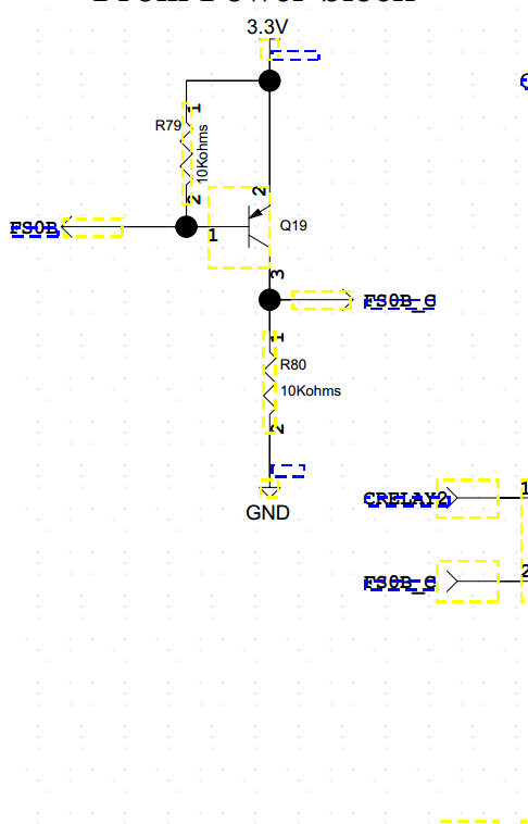

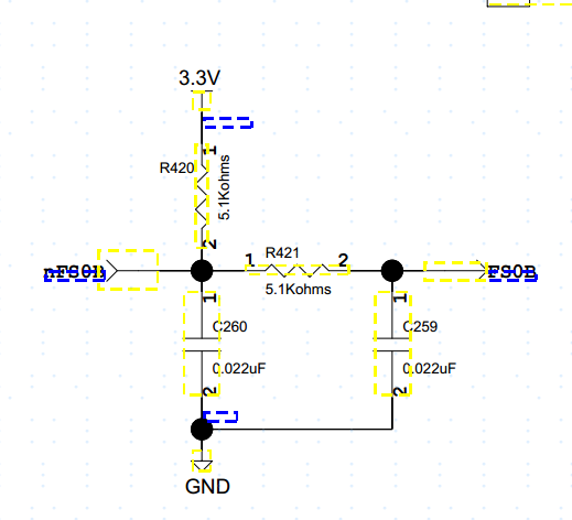

FS0B的电路看不清楚,能发清楚的图片吗关于FS0B的电路!
19,249 Views
347996379
麻烦帮我看看问题出现在哪里,结合上面的问题
19,251 Views
guoweisun
1:No more issue with your schematic.
2: For the release FSXB please read detail information procedure in page57 attached.

I would like to know whether the PIN of FS0B remains low after power on or reset.The software package you provided only has the function of releasing FS0B, but does not have the function of raising it.In addition, in debug mode, the output of FS0B is low or high.
19,251 Views
guoweisun
对的,每次power on reset  FS0B都是默认low的无论再哪个模式下面,所以我才给您release的方法。
19,251 Views
347996379
非常感谢!现在我已经能够释放FS0B这个管脚了,由于这个管脚我是用来做功能安全的,当CPU不能运行的时候,并停止了喂狗,在fs6503内部fs0b这个管脚有没有主动拉低的机制

guoweisun
这个SF_OUTPUT_REQUEST register寄存器的FS0B_REQbit 设置成1就是asserted low.
19,250 Views
347996379
可能你没明白我的意思,上面我说到CPU在完全死掉的情况下,主cpu还怎么能去读写sbc的寄存器?在这个时候sbc有没有主动释放fs0b的机制
19,250 Views
guoweisun
CPU都死掉了怎么可能去releaseFS0B!
19,251 Views
347996379
意思是这个管脚不能当做安全功能管脚用了?CPU非正常情况下,fs0b管脚不能锁住控制开关
19,251 Views
guoweisun
如果你不去喂狗,就会产生错误FS0B,这个时候FS0B就会被asserted.你说的锁住控制是怎么理解?
19,251 Views
347996379
发送错误的时候,FS0B的电平被翻转
19,251 Views
guoweisun
有错误是会翻转啊,前提是release了FS0B,这不就是安全功能吗?
19,251 Views
347996379
明白了,谢谢
