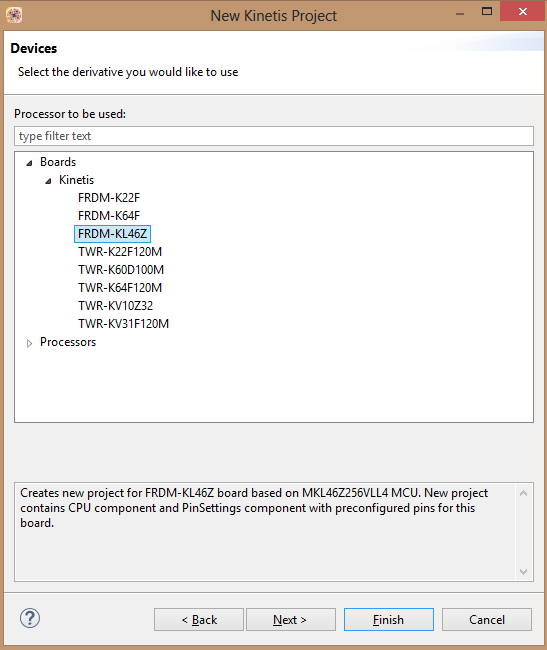

jackmonaghan
The FRDM-KL43Z is not their to actually start programming

Jorge_Gonzalez
Hi Jack:
Did you download KSDK v1.2 already?
You need to install the KSDK v1.2 Eclipse Update to Kinetis Design Studio (KDS). The attached guide is for KSDK v1.1, but the exact same steps are for KSDK v1.2.
Let me know how it goes.
Regards!
Jorge Gonzalez

Jorge_Gonzalez
Hi Jack:
Did you install the Eclipse Update? Please follow the guide attached to my previous post.

Jorge_Gonzalez
Hi Jack:
That is strange. I got FRDM-KL43Z without further installations, but there is however a standalone package for FRDM-KL43Z. Please try with that one, the detailed steps are in the next link:
FRDM-KL43Z and KL33Z - standalone package
Let me know if the problem persists.

jackmonaghan
Its working now. Thank You so much
