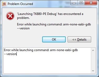

I tried this, it imports and builds, but when you try and flash to the target I get this?????
Exception occurred during launch
Reason:
Error while launching command: arm-none-eabi-gdb --version
I've never seen this before. Any ideas?
Thx, Johnny

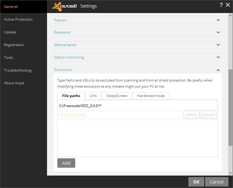

Please, do you see this error?
What do you use for antivirus?
Error message could be caused by moving "arm-none-eabi-gdb.exe" to Virus Chest in Avast.
Maybe could help, if you use Avast, add the path "C:\Freescale\KDS_3.0.0\ " in the list of exclusions for your Avast.
I mean
Please, tell me if it helps,
Iva
4,795 Views
johnnymclean
Yes, this is the error I get. As mentioned above, other demo's flash correctly, so it can't be an antivirus issue. If it was, I'd be seeing this error with all examples.

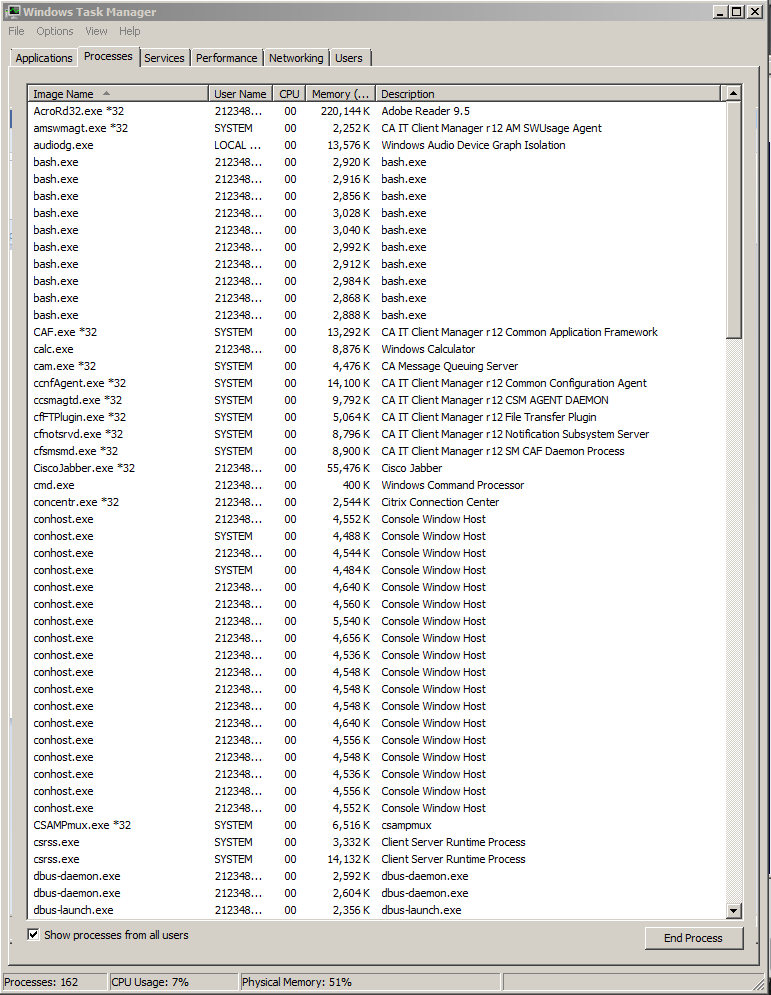

ivadorazinova
Hello ,

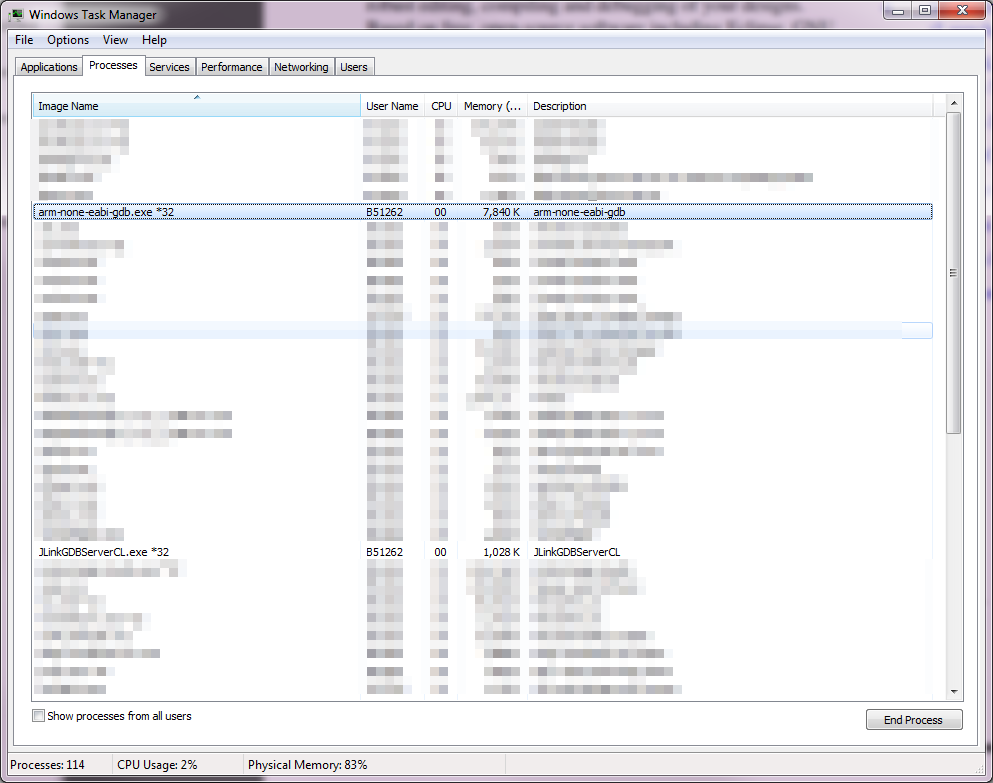

please try to end process for GDB Server and arm-none-eabi-dgb.exe from Task Manager and try flash again.
I hope it helps,
Iva
4,795 Views
johnnymclean
I don't have either process running on my system. KDS 3.0 is running and I can repeat the error condition.

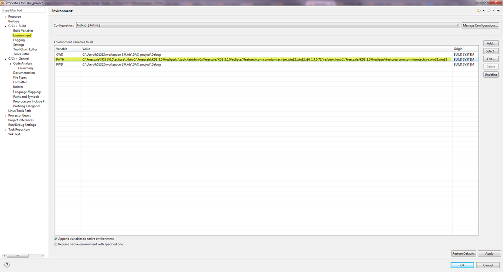

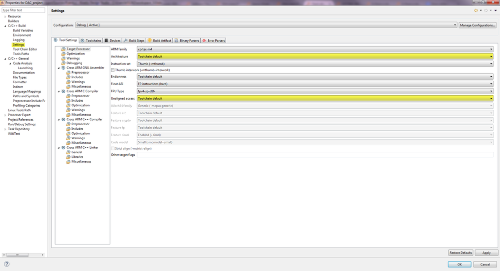

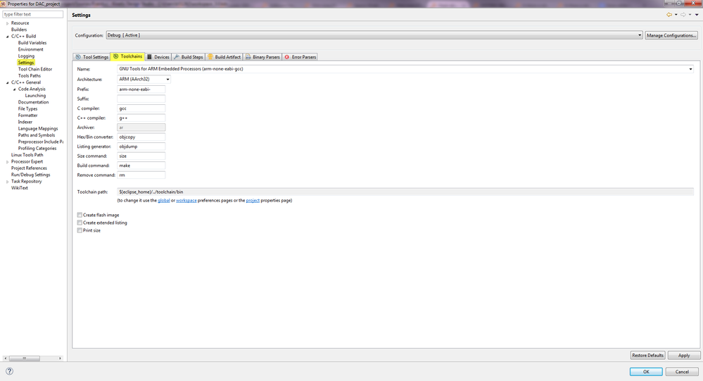

Please, check your toolchain settings according to mine: (please, get by right click on your project to Properties in KDS).
Please, do you see some differences?
Iva
4,795 Views
johnnymclean
Hi Iva, yes all my settings are the same. I can flash my project and other demo projects just fine. I can build, link and flash hello_frdmk64f and hello_world_frdmk64f just fine. It's just flash_example_frdmk64f that produces this weird error.
