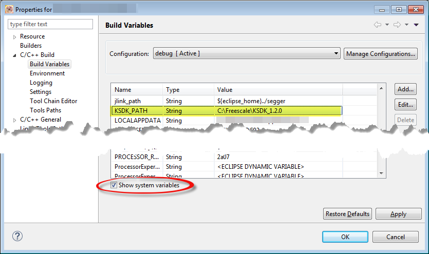

- Check that the build variable {KSDK_PATH} is pointing to your KSDK v1.2 installation (Project -> Properties -> C/C++ Build -> Build Variables):

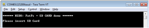

4- Reset the board. You will see this message:

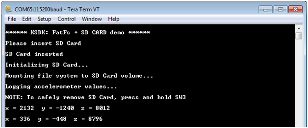

5- Insert micro SD Card. Now terminal should look like this:
6-  Accelerometer values will start to be printed to terminal and logged to SD Card each second.

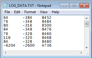

7- Now with a PC you can open the file LOG_DATA.txt:

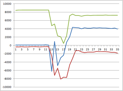

The file can also be opened by a software such as Excel to graph the results:

Hello Efrain:
As mentioned in this document post you need to first build the KSDK platform library and also make sure that the KSDK_PATH build variable is correct. Refer to "Getting Started with Kinetis SDK (KSDK) v.1.2.pdf" in KSDK doc folder: C:\Freescale\KSDK_1.2.0\doc.

Hello Efrain:
The path in that error is incomplete. If the library is not compiled it should report something like this:
So I guess you have not confirmed the KSDK_PATH variable as advised. Ultimately it does not matter if you use KSDK_PATH or PROJECT_KSDK_PATH (these are called build variables) but you need to be sure that either one being used is pointing to the correct path. Mark the check box for "Show system variables":
When setting paths also pay attention to the KSDK version. I built the project with KSDK v1.2, but I think you downloaded KSDK v1.3.
Then in the linker settings check that the path to the library is correct:
Let me know if the error is not resolved.
