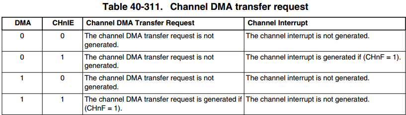

I'm using Channel 1 of FTM0, not Channel 0, because the FTM0_CH1 pin was available on my board. I have Channel interrupt disabled, but DMA request enabled, assuming that this is necessary to trigger the eDMA.
For some reason, the DMA is not functioning. I have an instance of the ftm_edma component in PE, with a single configuration. Auto initialization is checked, and Init configuration 0 has FTM0_Channel1_Signal selected as the Request. Channel is Fixed, and is set to DMA_Channel4 (it seems prudent to leave channels 0 through 3 because they have additional capabilities). I assume that the latter two settings (Request & Channel) are all that is needed to configure the DMAMUX properly. I've checked Callback and have a function named dma_Controller1_Callback4. On the Interrupts page, I have all DMA channel interrupts disabled except for INT_DMA4. DMA channel interrupt priority is enabled and set to minimal priority. Install interrupt is enabled, and the ISR name is dmaController1_Chn4IRQHandler.
When running, breakpoints show that the DMA interrupt is not called. Examining memory, it seems that the DMA never writes any value.
In my code, I call EDMA_DRV_PrepareDescriptor(), EDMA_DRV_PushDescriptorToReg(), and EDMA_DRV_StartChannel()
Is there anything more I need to do to ensure that the DMAMUX and eDMA peripherals are properly configured and enabled? I've looked at the Processor Expert Generated Code, and it seems that everything there is correct. I'm just not sure whether anything is missing. Is there a DMAMUX component needed? Do the eDMA settings take care of the DMAMUX initialization? Where are the #define values for the K64F that list the options available on my chip?

Please be sure that the bit in the register FTMx_CnSC[DMA] is set.
The input capture mode does not allow to restart the FTM counts by itself but I recommend you to take a look into the Dual Edge Capture - Period measurement mode. Please read about it in the section 40.4.24.4 in the K64 reference manual.
