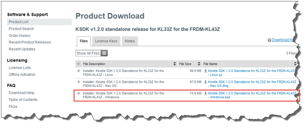

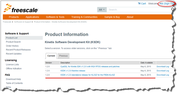

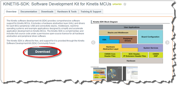

Go to www.freescale.com/ksdk and click to download

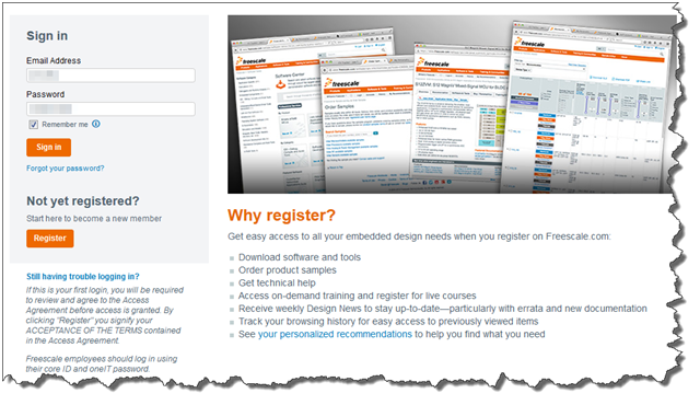

Is needed to be signed in
After that is seen standalone package for FRDM-KL43Z and KL33Z

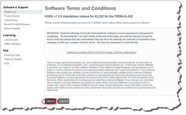

Agree with Software Terms and Conditions

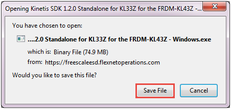

Choose installation package according to platform

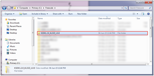

Save file and install it
After installation, final folder appears at C:\Freescale\KSDK1.2.0_KL33Z_1.0.0
and Eclipse update - import package to KDS from C:\Freescale\KSDK1.2.0_KL33Z_1.0.0\tools\eclipse_update

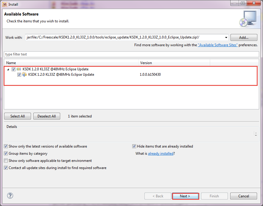

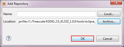

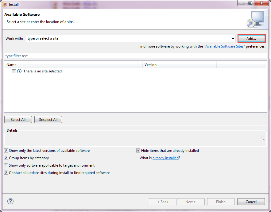

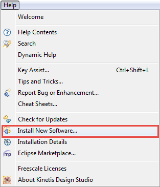

In KDS choose Install New Software

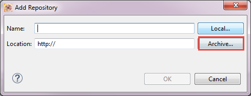

Click Add

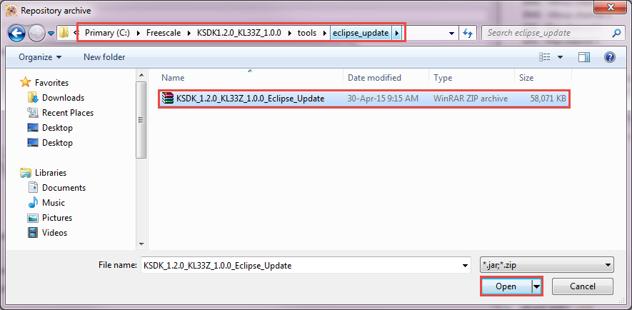

Choose Archive
Choose the Eclipse Update zip file located at C:\Freescale\KSDK1.2.0_KL33Z_1.0.0\tools\eclipse_update

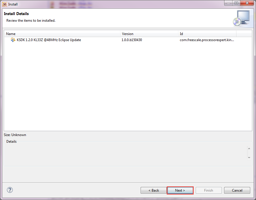

Select update for KL33Z and KL43Z

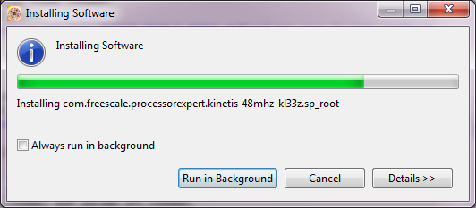

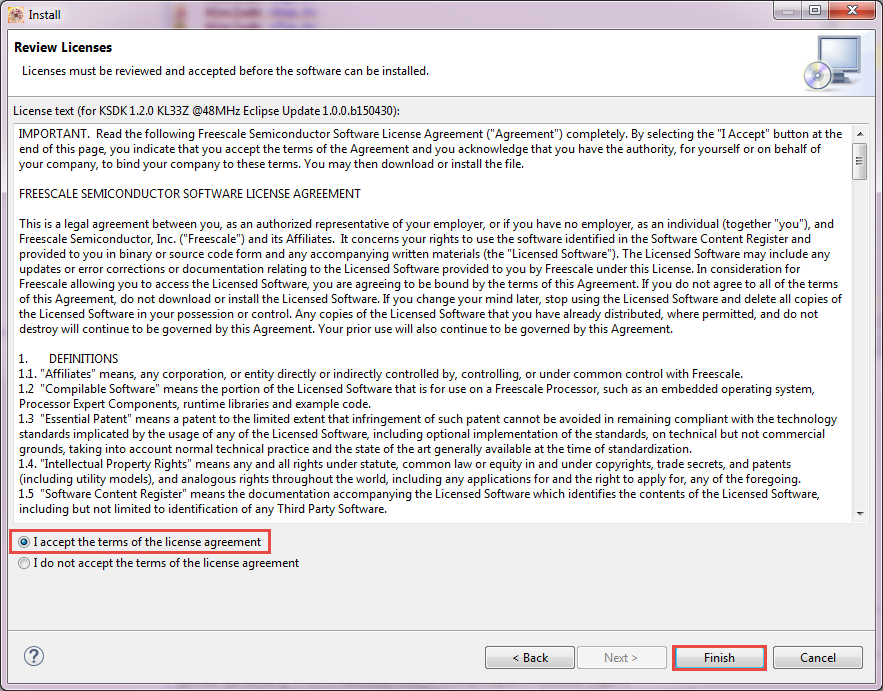

Accept terms of the license agreement
:-) Enjoy!
