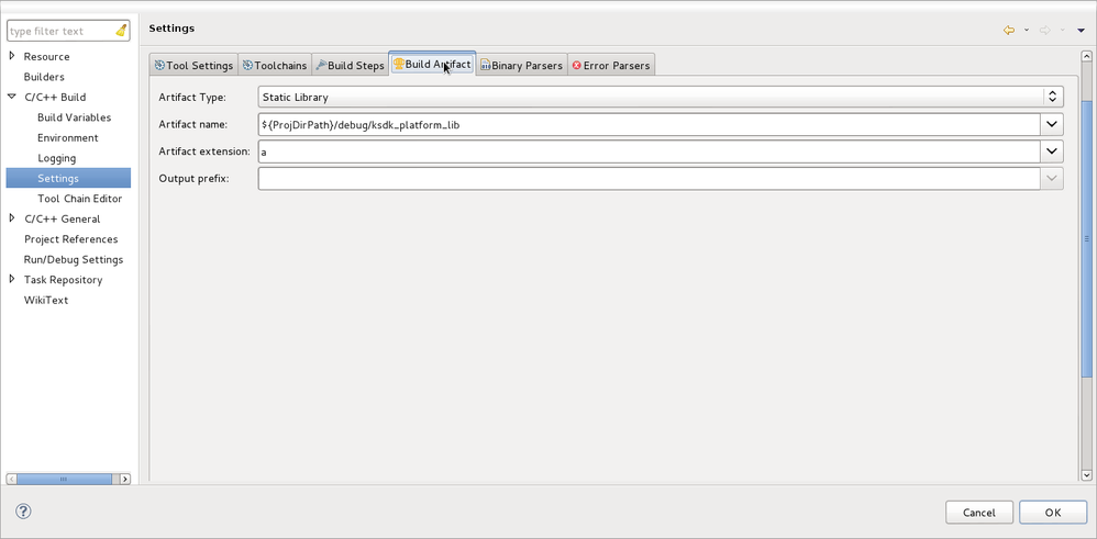

I found and solved this issue. I hope it will help maybe other people who want to use linux to code.
It's a really common mistake on Linux which is case sensitive.
Under Kinetis Design Studio, in the ksdk_platform_lib_KL43Z4 project properties, when you check the "C/C++ Build -> Settings -> Buld Artifact" tab, you can see the artifact name is "${ProjDirPath}/debug/ksdk_platform_lib" or "${ProjDirPath}/release/ksdk_platform_lib". But it looks in fact for Debug or Release folders and not for debug and release. So you have to change the value of the folder in this text field.
I hope I have been clear.
Antoine.
