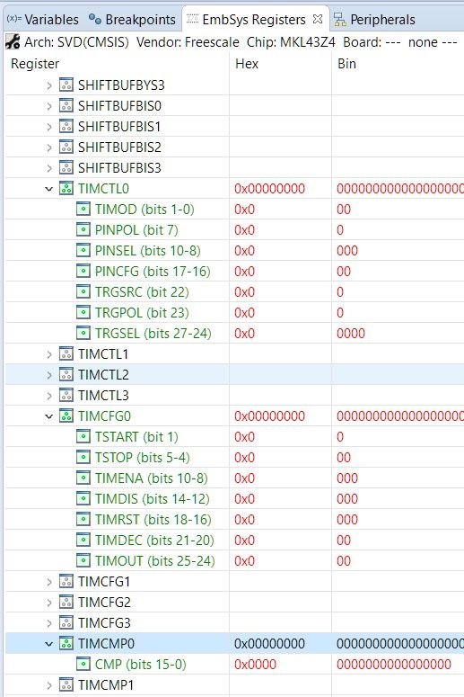

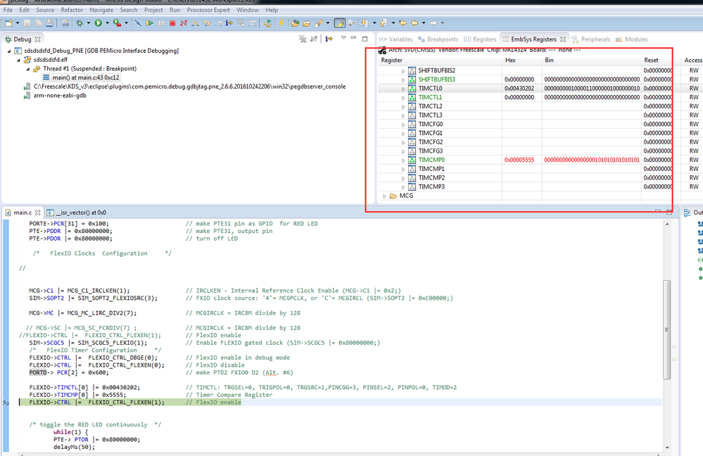

I can’t read FlexIO registers during debugging using "EnbSys Register"  window view.
I’m using KDS 3.2 & KSDK v2 and P&M SDA to evaluate FlexIO on FRDM-KL43Z board.
I wrote two PWM simple test programs, one that uses API and the other direct FlexIO register configuration (Bare-metal).
Reading FlexIO registers fails in both test it returns zero result.
As you can see at the same time reading other peripheral is O.K
Using API I have problem no output (probably configuration).
The Bare-metal program is working well I have output on PTD2 pin.
Using “not working” FlexIO display I have changed manually TIMCMP value from 0x7474 to 0x5555. The change has been accepted and PWM cycle has been changed.
Reading again this register returns again zero value.

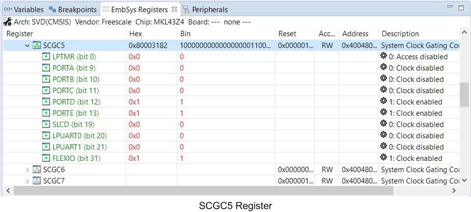

rastislav_pavlanin
Hi Shaul,
sorry, it was mistake in nameing. In general it means that if the FlexIO is not clocked yet - means SIM_SCGC5 has disabled FLIEXIO bit field.
regards
R.

shauldorf
Contributor V
It's not my case.

Hello shaul,
The problem is not the clock , it is PE debug firmware , also sorry my mistake.
Please change the debug mode to Jlink on board , then when set to 128 128 ,
it also can work well .
I attached the jlink firmware , please copy and paste it into the bootloader of board .
The detail steps you can refer to "Updating the OpenSDA Firmware.pdf", I also attached it .
Hope it helps
Alice

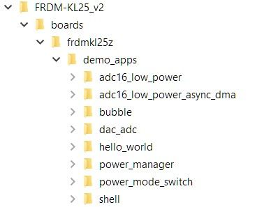

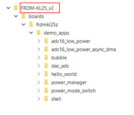

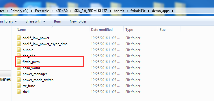

Hello Shaul,
- It seems you open the package for KL25 device ,while you use the KL4.
This it your screenshot :
Please search the demo under :
- And yes, i have run your project , when it run into the code about FlexIO, it will crash.

shauldorf
Contributor V
Hello Alice
I looked in NXP demo “flexio_pwm_frdmkl43z.
This demo is using RC48M as a source clock for FLEXIO.

In my project MCGIRCLK is used as Timer source clock.
This clock is divided by two dividers MCG_MC[LIRC_Div2] and MCG_SC[FCRDIVthat can be configure by :
1. BOARD_BootClockRUN() (file clock_config.c) or
2. directly by
a. MCG->MC |= MCG_MC_LIRC_DIV2(7); // MCGIRCLK = IRC8M divide by 128
b. MCG->SC |= MCG_SC_FCRDIV(7) ; // MCGIRCLK = IRC8M divide by 128
Doesn’t matter how you configure it in my opinion there is a problem with combination of those two dividers.
Doing few tests I found that the combination of 128 x 128 for DIV2 and FRCDIV is not working.
If for example you will configure it to 128 x 1 or 1 x 128 it will work and this is your working test.
Because writing to MCG register is working you can do simple manual test.
You can change divider values at break point, then run and break point again and see the result if there is flexio read zero or it is OK.
So to summarize it, the question is if there are any limitations on this clock?

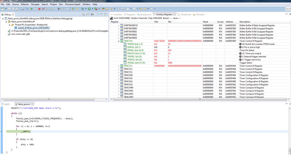

18,506 Views
Hello Shaul,
- I think it is not the problem of "EmbSys Registers" view, please check the initialize of you FLEXIO code .
- It seems you use the KSDKv2.0 lib ,  there is a FlexIO_pwm demo under KSDK v2.0 , please refer
to it  :   SDK_2.0_FRDM-KL43Z\boards\frdmkl43z\demo_apps\flexio_pwm
I test it on my side , the register can work well :
Hope it helps

shauldorf
Contributor V
Hello Alice
I’m attaching my working main.c file
While program is in “Suspend” All registers are visible accept FlexIO peripheral.
