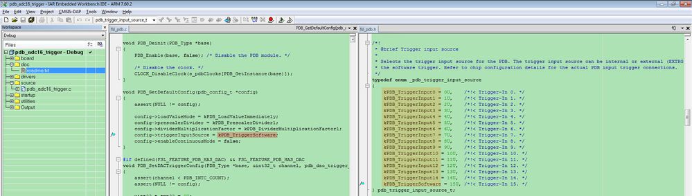

I try to configure the ADC (ADC1)  in hardware trigger mode using a PDB channel as the ADC trigger.
Which PDB trigger Input source should I use ?
Is there any examples in KSDK 2.0 for such a thing ?
Thanks for your help

Hi Nadine,
Please look at following example to see if it helps.
C:\NXP\KSDK_v2\SDK_2.0_FRDM-K64F_KDS\boards\frdmk64f\driver_examples\pdb\adc16_trigger
David

Hi Nadine,
You can refer that example.
The PDB trigger Input source can be found at "Table 3-57. PDB Input Trigger Options" in K64P144M120SF5RM.
You can try to change the PDB trigger Input source.
Robin
