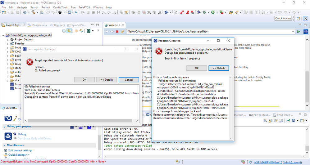

Hi All,
Good day.
I have just bought a FRDM-K64 evaluation kits and following the tutorial step by step to test on it. Unfortunately, I am having the communication issue between the evaluation kits to the mcuXpresso IDE.
anyone can assist on this issue or anyone is facing the same problem?
please advice, Thank you very much.
Ben.

Please make sure you are using the latest MCUXpresso IDE and the latest OpenSDA firmware application in your board:
MCUXpresso IDE|Eclipse-based Integrated Development Environment (IDE)|NXP
OpenSDA Serial and Debug Adapter|NXP
Once you update the OpenSDA firmware application you will need to delete the Launch Configuration files in your project ({projname}{debug solution}Debug.launch and {projname}{debug solution}Release.launch) and create them again, simply highlight the appropriate project in the ‘Project Explorer’, and then in the Quickstart Panel click on Debug 'Project Name', alternatively click the blue bug icon to perform the same action.
Also, please make sure there are no hanging debug processes by clicking on the "Clean up debug" icon:
Hope it helps!

I have this same problem every single time I reconnect my dev board to the USB debugging port. There is a workaround but you have to perform it EVERY SINGE TIME, so it is frustrating and time consuming when you are working on something that requires you to disconnect and reconnect the USB! Hopefully someone has a more permanent fix. It's honestly kinda ridiculous that a problem like this exists and remains undocumented with a development kit! It doesn't give one much confidence in the ecosystem as a whole!:smileyangry:
In order to get around this:
  • Open the "GUI Flash Tool" in the toolbar (the DIP looking icon)
  • Select OK when it finds the target ("MBED CMSIS-DAP" for my K22 freedom board)
  • In the "Target Operations" section click on "Resurrect locked Kinetis device"
  • Hit "Run"
It will connect, complete the script and now you'll be able to run the samples.
Oh yeah another peculiarity: On my K22 board at least, the LED is a 3-color and the firmware seems to be written for a different iteration of the board/LED. So it doesn't change colors like you'd expect when you run the demos that change the LED; blinky, level, etc... But if you look at the schematics it's pretty easy to figure out how to change the GPIO settings to get it to change to the correct colors. It's actually a pretty good, easy activity to learn how the pins/ports work.
If anyone knows a permanent fix for the debug port that would allow us to avoid running the resurrect script every time we connect, it would be much appreciated!!!
