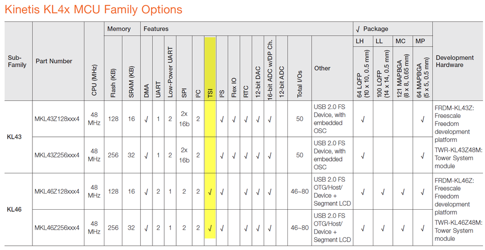

Hi ladys and gentelmen,
I am currently prototyping the FREEDOM-KL43. I failed to add a TSI element to the PEx project. If I change in PEx's component library  from "applicable to project"  to "all" I can find it in the list. But if I add it it cant find a device. Pressing ctrl+space to the device shows me clear list.
Also if I asked it is interesting for me can it sense a finger covered by rubber gloves?
Thx a lot guys!

Hi Alexey,
according to KL4x fact sheet
http://www.freescale.com/files/microcontrollers/doc/fact_sheet/LSERIESKL4FS.pdf?fpsp=1&WT_TYPE=F...
TSI device is not available on the KL43 derivatives . This device is available on KL46 derivatives only.
so fsl_tsi component is not available on the KL43 derivative.
does this answer your question?

alexeyusoltsev
Ok, get it-library dont support kl43.
It's a bit weired because FRDM has slider. The only option for me is to use Init_TSI ? Or do i need to write it from scratches?
UPD.:processor have no TSI in it.
