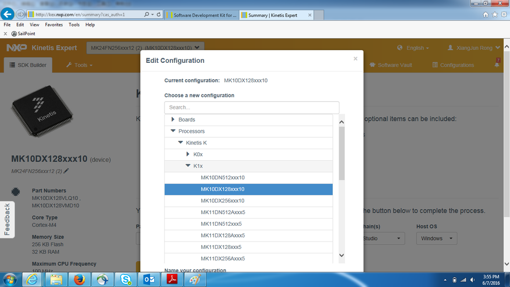

I checked SDK1.3 again, it only support MK10DX128xxx10 with 144 pin series. Not 48-pin VFT5 package. The build package from website based shows the same thing.
Please let me there is SDK package includes 48-pin QFN package. it will great helpful for code development.
HJ
2,965件の閲覧回数
xiangjun_rong
Hi, Xu,
I have checked the KSDK website, there is not the SDK2.0 or SDk1.3 for the 48pins VFT5 as the following screenshot. But I think you can use the sdk1.3 driver for MK10DX128xxx10 with 144 pin serie for the K10DXxxxVFT5 , and you just need to change MCG module so that it can output 50MHz instead of 100MHz, for the peripheral, they have the same base address,pin assignment is the same. you can change the linker file based on the actual memory size. it is okay.

xiangjun_rong
Hi, Xu,
I think the SDK1.3 supports the MK10DX128VFT5, pls download sdk1.3 from the website based on your own processor.
http://kex.nxp.com/en/summary
Hope it can help you.
